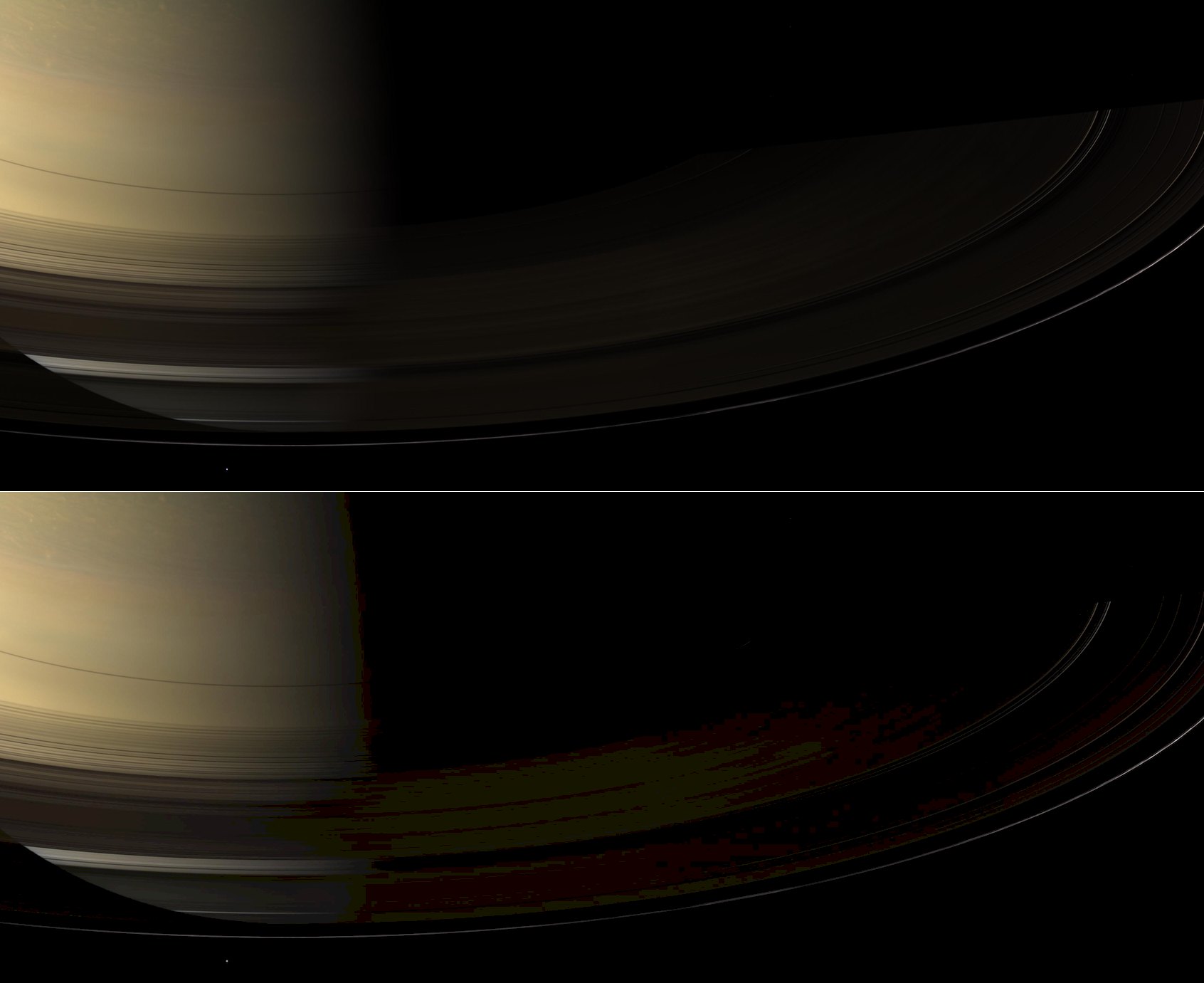

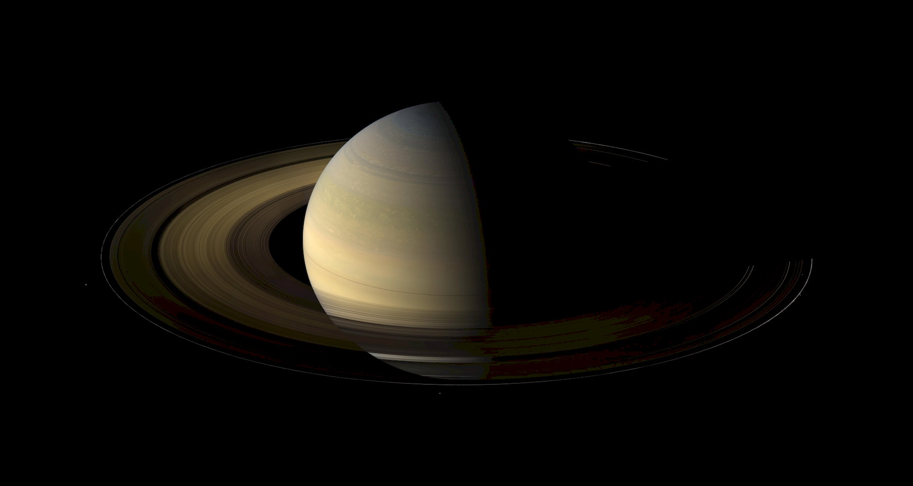

Downscaling an image with gamma correction posterizes dark areas. See the attached image (50% size of the original).
To reproduce, downscale an image with "Use gamma correction" enabled.

The posterized image you see in my post is the downscaled version of the original. I don't see any artifacts on the original image:

Try downscale to e.g. 1806x961 pixels. You can see the output image in the first post: download/file.php?id=5149&mode=view

On the Saturn rings. I attached an image with side-by-side comparison.
Posts: 48933
Re: 0.92: Downscaling with gamma correction posterizes dark areas
yes a known issue on dark color

Just ran into this issue and was wondering what on earth was going wrong until I tried turning gamma correction off.
Top image is original, bottom is resized to 1919x1079, nearest neighbor with gamma correction enabled:
