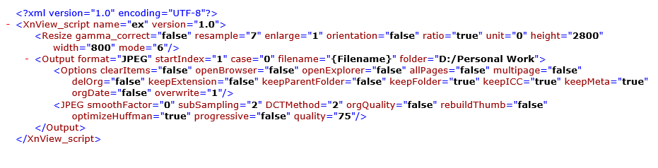

So I have a xbs file which has the complete convert configuration I want to use. Can use this file as a input to nConvert? It doesn't seem that I can. I had also hoped to use the export to batch function, but that doesn't include any of the output format options. It only included the resize options.
At the moment, all I'm trying to do is convert and resize a single specified image, and specify the output location. What is the best way to accomplish this using only scripts? If the only way is figuring out the nconvert syntax, can someone assist? I didn't find the "user guide" to be particularly helpful.
Below is basically what I have so far. It doesn't work right. I have attached a screenshot of xbs config file. Any help would be appreciated.
nconvert -out jpeg -q 75 -opthuff -dct value 2 -smoothingf value 0 -subsampling value 2 -keepcspace -ratio -rtype lanczos -rflag decr -resize 10000 2800  -o "D:\Test\output.jpeg" "D:\Test\input.png"

It turns out the issue with the code was simply that I had the switches wrong. If anyone is curious the correct is:
nconvert -out jpeg -q 75 -opthuff -dct 2 -smoothingf 0 -subsampling 2 -keepcspace -ratio -rtype lanczos -rflag decr -resize 10000 2800  -o "D:\Test\output.jpeg" "D:\Test\input.png"
