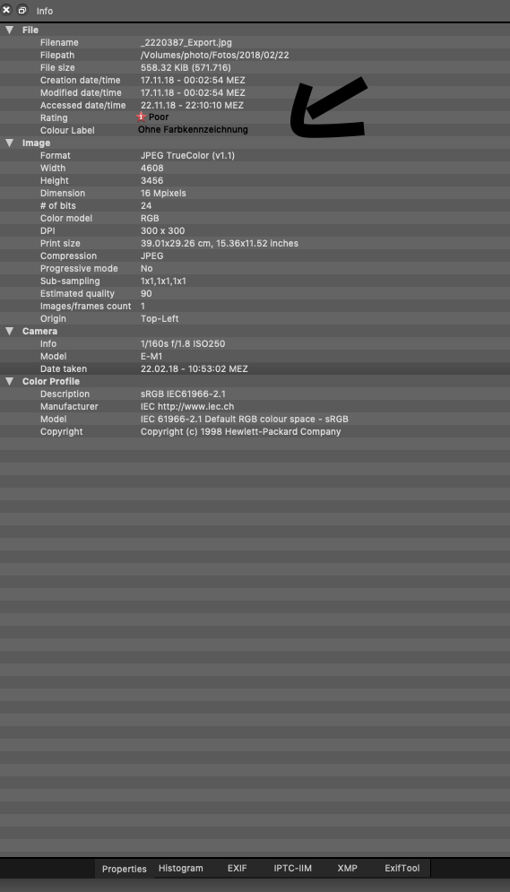

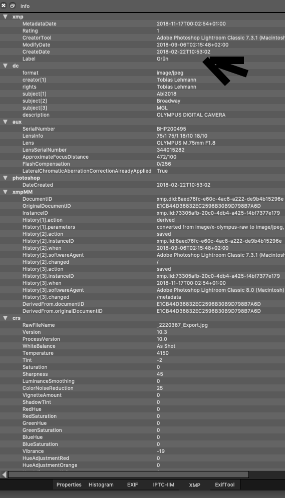

Re: Making the switch
Hi thanks for your reply!
I made two Screenshots from the Infoscreen of one picture.
Hope this makes my problem visible?

XMP color label was written by Lightroom. ok.
The field you are showing in the 2nd screen (File group) shows Xnviemp database content; this database allows searches and filters.
To create or update database, select images and click "update catalog from files" in "view" menu.
But before, you must choose your import options in settings, metadata ...
Hmm, this still didn't work..
could there be a problem with the language?
If I set the lable in XNView to "green" it writes "green" to the XMP.
The "green" Lightroom Lable is called "Grün" in the XMP file
Btw. After Changing the color Lable the XMP file is deleted and I have to rebuild it via "Update catalog from files".
- Posts: 1582
You are right
I believed xmp color label was coded like other metadata (like star rating, with a number).
But no, it's only a "string", so you can write xmp:label=Churchill if you want !
It would have been more efficient to choose a numerical value (see Digikam link below)
I don't know if xnviewMp can read german color label when german language is enabled... and so on for other languages. I think it's not possible.
I'm going to create a new post to ask this to Xnviewmp author
(viewtopic.php?f=60&t=38191)
I'm using french or english version, and it works (only ?) with english names for colors.
Xnviemp GUI is able to translate colors for display only (settings, metadata, labels) , it's not useful for now.

- Posts: 1582
First attempt with exiftool through XnViewMP (Windows)
- Select a picture, right click (secondary click on Mac OS) , "Open with", "Configure programs" ...
- Click Add button, browse your Hdd, find your xnviewmp installation directory, then "AddOn" directory, select exiftool and click "Open" button.
- A new line is added in the table. Edit content of first column (double click) and choose a name ... ex : Green
- Edit 2nd column and enter exiftool arguments : -k -m -if "$xmp:label eq 'Grün'" -xmp:label=Green
ok
For Mac OS, I think the right arguments for Exiftool are : -k -m -if '$xmp:label eq "Grün"' -xmp:label=Green
(with double quote around the word "Grün" and simple quote around the whole IF command )
-Try on a test image
- I didn't try this on XMP sidecar files ...
This function replaces Grün by Green in selected photos.
Maybe a function exists to process all five colors in one shot, but unfortunately Exiftool forum is down since last saturday.
If it works , you can use the same command in a terminal , directly with exiftool.
Add -r for recursive processing, and a directory name
For Windows, exiftool is called by typing :
exiftool -r -k -m -if "$xmp:label eq 'Grün'" -xmp:label=Green "C:\photos\2018"
On Mac OS, I dont know, maybe something like :
exiftool -r -k -m -if '$xmp:label eq "Grün"' -xmp:label=Green 'C:/photos/2018'
Backup files are created with "_original" extension.
If you want to restore all _original files use : exiftool -restore_original -r 'C:/photos/2018'
if you want to delete them, use : exiftool -delete_original -r 'C:/photos/2018'
if you are very sure, you can add -overwrite_original in exiftool arguments to prevent backup files to be created.
