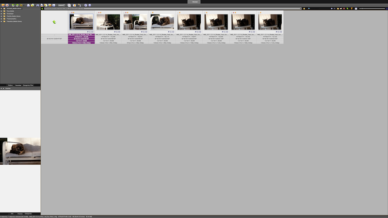

    5. On occasion the full screen image can appear first on the main screen, but following presses of the command for full screen display will alternate to the second monitor. Here is a pic of my main screen.

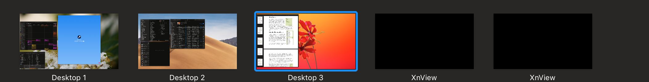

A work-around for this problem is using the system commands on a Mac to move away from the blanked out screen thus created.
The steps to recreate are described with the above and are clear and repeatable.
