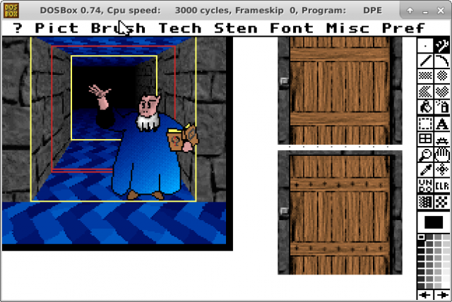

And for everyone interested, this is what the image is supposed to look like:
True, but you can trick the system. Add a permitted extension to the file name and provide some info to remove that extension before attempting to view it. Or actually compress the image to a ZIP, RAR or 7-Zip archive.gilles504 wrote: Tue Feb 05, 2019 11:20 amphpbb does not permit .bbm extension in attachment (or maybe it's firefox in mime types)

Thanks, last time I saw this one was on my 486 with DPE
(or maybe with doxbox)
to be close to perfection bbm should use the transparency color because it's a brush. (tranparency is defined somewhere in the "BMHD" section if I can trust my old Borland C code).

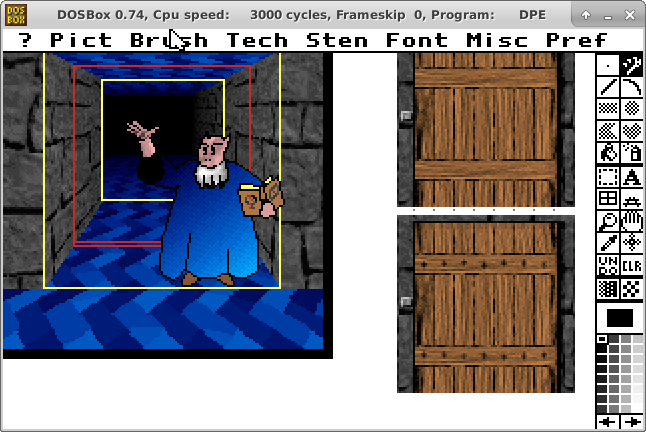

just checked with DPE and the tranparency is defined (I think it's the 0xFF white at the end of the palette):
in my old code section "BMHD" is len(32) brushx(16) brushy(16) ??(16) ??(16) ??(16) ??(16) transparency(16) ??(??)
If I remember correctly dpe uses the last background color to define the brush transparency color.
