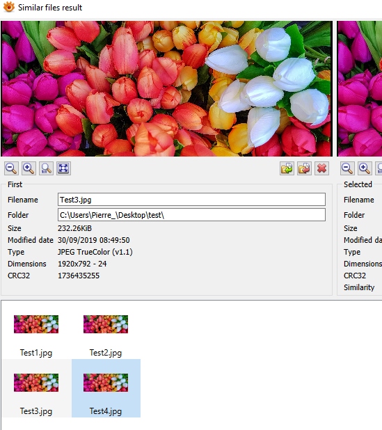

- Posts: 48625
Re: XnViewMP 0.93.1 - similar files - problem with deleted files
strange i have that
