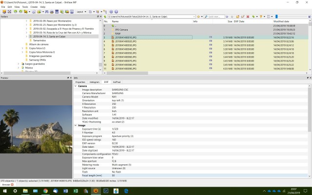

After the use of Attribute Changer the EXIF Date is not correctly shown in Detail View but it seems fully correct in EXIF Tab. Weird.
Just look at the screenshot I upload. All the EXIF Date times are shown as 0:00:00.

there is a problem in the date written "2019:04:21 21:13:442019:04:21 21:13:44", as you an see the field contains 2 dates...

Ok Pierre, thanks. Please, would you mind elaborating a bit more in order to inform AC coders of their bug?xnview wrote: Tue Apr 23, 2019 7:27 am there is a problem in the date written "2019:04:21 21:13:442019:04:21 21:13:44", as you an see the field contains 2 dates...
(I mean which field/metadata/EXIF property/whatever_it_is_called is affected by it. Xn View's EXIF Tab does not show anything wrong so I don't know where the bug is).
- Posts: 48870
Re: 0.93.1: EXIF Date is not correctly shown in Details (after Attribute Changer)
the EXIF date taken has this value
