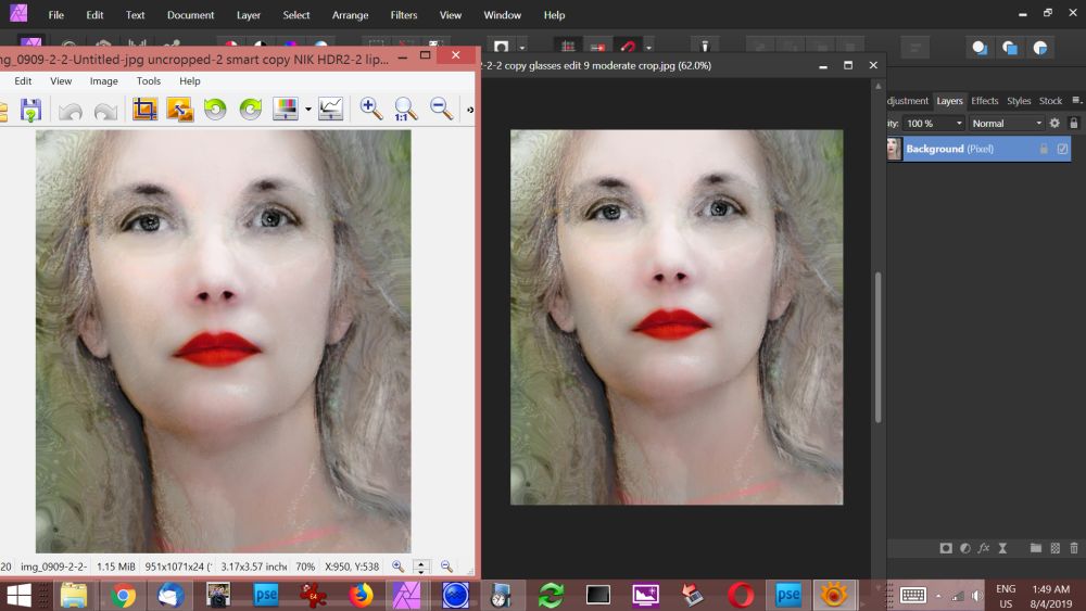

XnView MP stretches image
Post by ncJohn »
I opened a TIFF file in XnView MP and thought it looked "longer" than normal. So I used "open with" to open the same file in my editor and the two images are quite different. In the example posted, it's very easy to see because the eyes are approximately at the same level but the chin in XnView MP is quite a lot lower.
I thought perhaps this was a known issue but I did a forum search for "distort" and "stretch" and didn't find anything. Can someone tell me how to prevent this?
Thanks
I'm using version 0.93 64-bit on Windows 8.1 Pro 64-bit.

ncJohn wrote: Sun Aug 04, 2019 6:14 am I opened a TIFF file in XnView MP and thought it looked "longer" than normal. So I used "open with" to open the same file in my editor and the two images are quite different. In the example posted, it's very easy to see because the eyes are approximately at the same level but the chin in XnView MP is quite a lot lower.
The chin is lower, but the face is also wider...
If you adjust the scaling in XnView MP (there are various options in Tools > Settings... > View -- View tab for finer control if you need it) is the effect still apparent?
Are you able to measure the width and height of each image on the screen reasonably accurately and calculate the ratios?
Is the effect still present in the image when saved, so that you could upload the two versions for comparison?
The ultimate test might be to create a circle in a drawing program and save the drawing in an image format, then view the image on the screen.

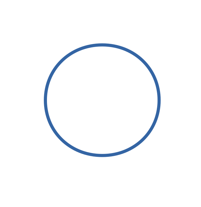

Further to my post above, and to Xntriq's post above:
The attached image of a circle, drawn in Libre Office Draw, should enable the accurate display of images to be verified, tested in XnView MP 0.93.

Well, I did measure them and they're the same. :(
In trying to figure out why they look different to me, I changed the background color in both programs but that wasn't the problem. Finally, I put the two programs side by side with reduced windows and I found out that whichever image is on the left looks longer/taller to me! In fact, even with an image of a circle, if I put them side by side, the one on the left looks like an oval. I thought maybe it was my monitor but no matter where I put them on the screen, the effect is the same.
So the software's fine, it's just my brain. :?
Sorry for the trouble, and thanks.
