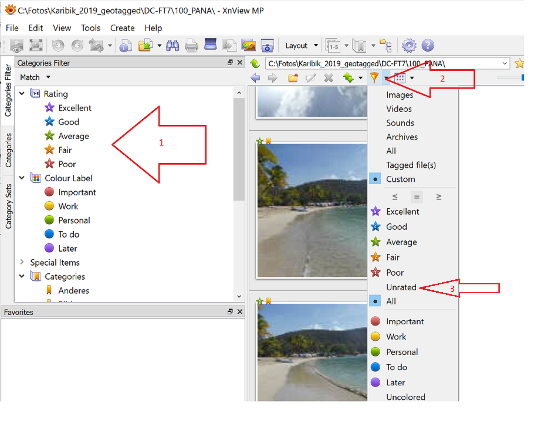

Now with your input and looking again a little bit better I found now the funnel symbol (2), which has my required "unrated" field (3).
Before I was looking only at the categories filter (1), which has similar functionality as the funnel (2), but w/o the "unrated" possibility.
For me this now perfect
, maybe it would be nice that to add the "unrated" also to the category-filter in the future
