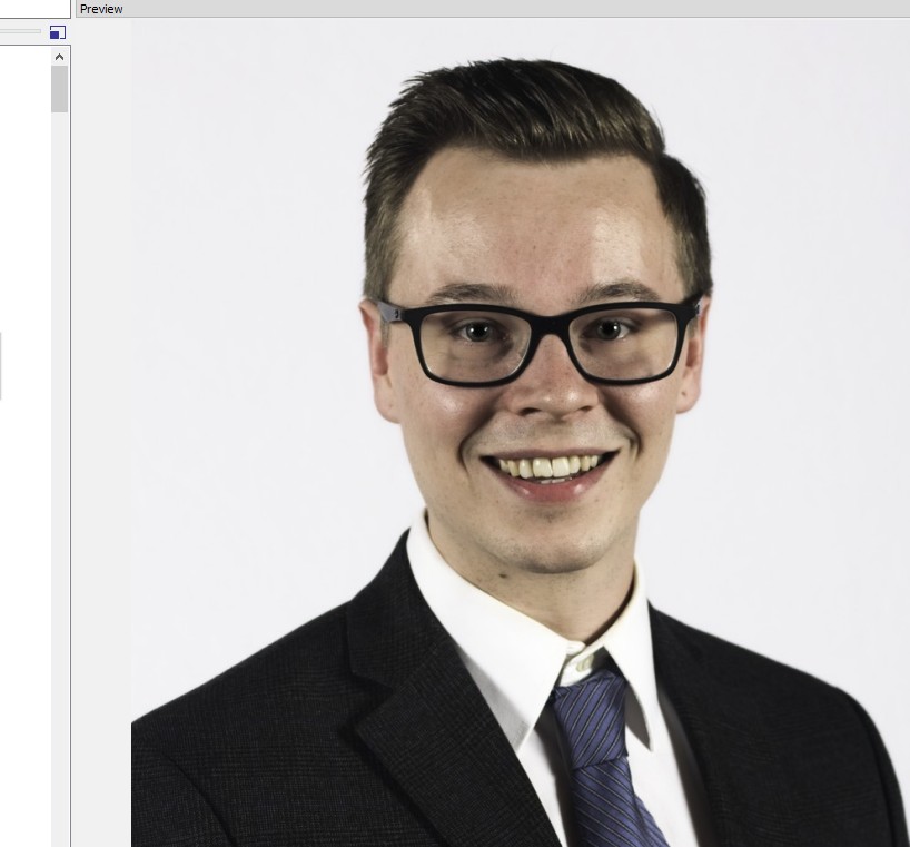

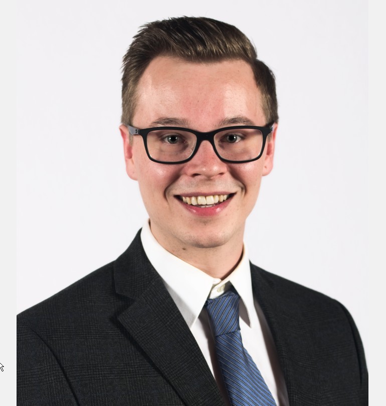

Hi all, I output a TIFF from Alien Skin Exposure via Affinity Photo and from the attachments you can see that the thumbtack and the preview look great but when I export using Batch Convert to change the resolution and export a JPG it comes out with the color all messed up. Can anyone help me understand why?

On the Batch convert Output tab there is an option Preserve color profile which you may need to enable...

Well, look at that! Thank you!
