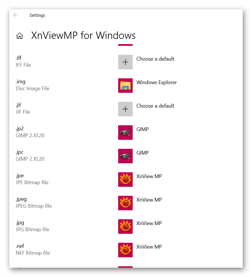

How do you get xnview to show .jfif files on windows 10 pro? you can't specify the file type association in xnview. windows app defaults settings will not allow you to select xnview for .jfif file type. and i don't see a plugin for .jfif. thanks.

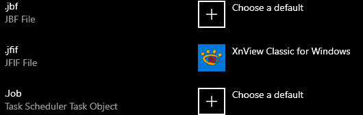

Well, this is interesting.
If you right click the file and select "Open with", then select XnView (which is possible here and not in Settings) and select "Always use this app to open .jfif files"; it opens XnView with an < Empty > file. This would suggest to me that there is an integration problem between XnView and Windows 10 Pro (OS build 17763.678). It stays associated, but always opens < Empty >. The association also shows in Windows>Settings now; so that is only part of the underlying problem.

I'm having trouble associating JFIF images with XnViewMP 0.96.5 64bits, double clicking on a JFIF image in XYplorer pro opens XnViewMP in Browser mode but thats as far as it goes.
