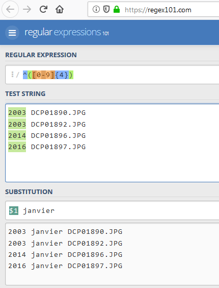

I'm trying to build a reg. exp in a sand box (regex101.com)
I want to add a word in filenames ... by replacing (year) by (year janvier)
This is working, the four digits of (year) are stored in $1

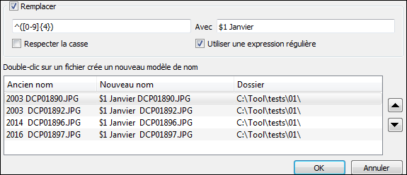

But XnViewMP does not process $1 in batch rename

you can't use $1, please try
->DCP
janvier DCP

Six years later, I found the answer in this post
Thanks to Jkm ...
Instead of using $1,$2,$3... we must use \1 , \2 , \3
In my example : replace ^([0-9]{4} by \1 janvier
Thanks to Jkm ...
