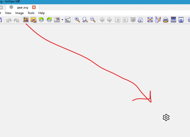

Maybe there is no problem with LOADING svg, but there is with PREVIEW`
but if you double click on file XNV will show it correctly in separate tab`

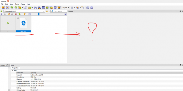

Excuse me, I lost the answers because there were no notifications. Subscribed now. I meet this problem again with new 0.95, started to google and found this post.
The same problem.
Setting you asked
No icons in the listing or view panel. Opened in Chrome and Illustrator well.

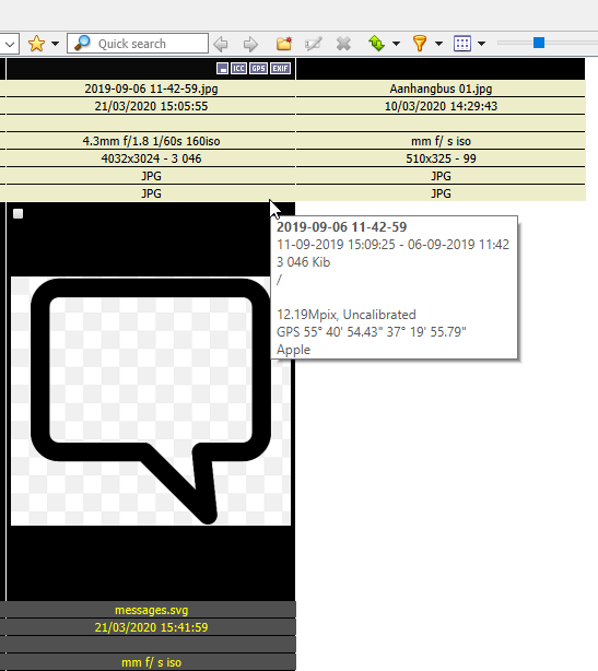

Just installed from the the site, the problem still exists with 0.96, but no problem with 0.93.1xnview wrote: Sat Mar 21, 2020 2:43 pm with 0.96, no problem wit this SVG Capture-1.png
No thumbnail & no preview?
