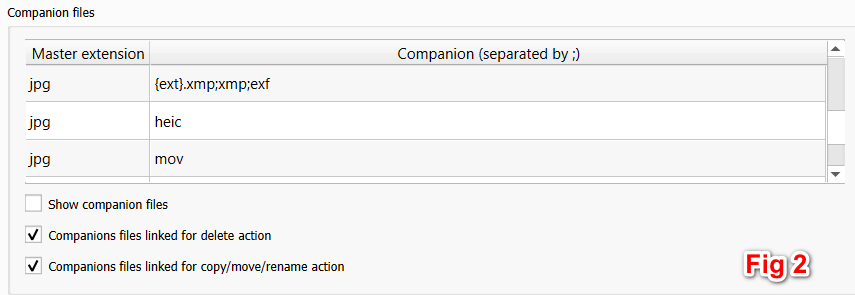

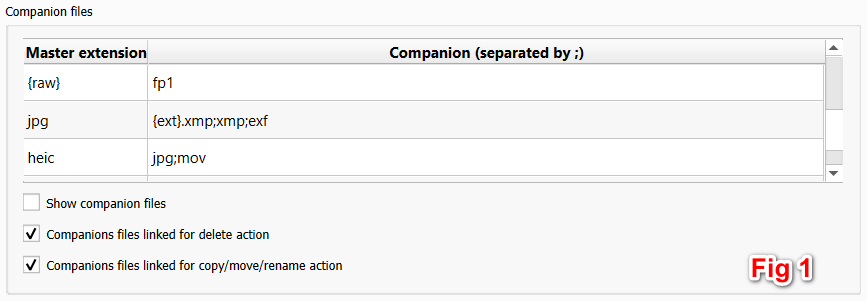

Settings as per the Fig 1: JPG and (or) MOV as companion file(s) to HEIC, both JPG and (or) MOV are shown.
Settings as per the Fig 2: Problem arose in beta 1 and 2 but not existed in 0.99.7: HEIC and (or) MOV as companion files(s) to JPG, both HEIC and (or) MOV are shown.

newuser wrote: Mon Apr 11, 2022 8:46 am Settings as per the Fig 2: Problem arose in beta 1 and 2 but not existed in 0.99.7: HEIC and (or) MOV as companion files(s) to JPG, both HEIC and (or) MOV are shown.
I can't reproduce, i've put file.jpg, file.heic, file.mov in a folder, and only file.jpg is shown
