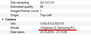

I convert old photos and change the file name, which then, among other things, should contain the camera model ({EXIF:Model}).
But, the batch conversion fails if there are strange EXIF entries (see attached picture).
Can XnViewMP automatically exchange characters that are not allowed in the file system?
As a user, I am unfortunately unable to do this during batch conversion.
Thank you!

Thanks, of course it works.
But, unfortunately, renaming with Replace/Regular Expression cannot be combined with converting.
My plan is to reduce the size and copy it to another directory with changed file names.
Ok, it works now, but with 2 steps.
