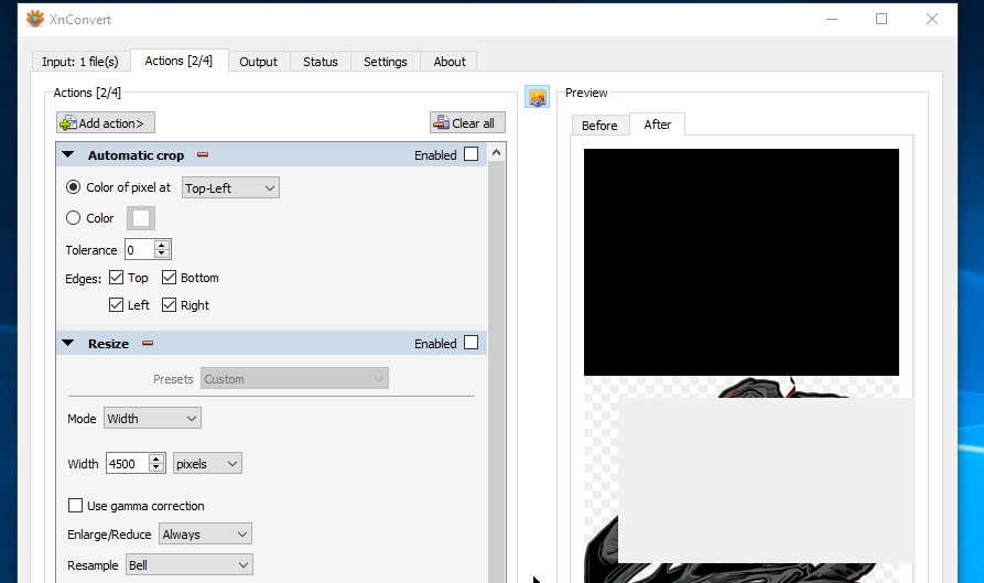

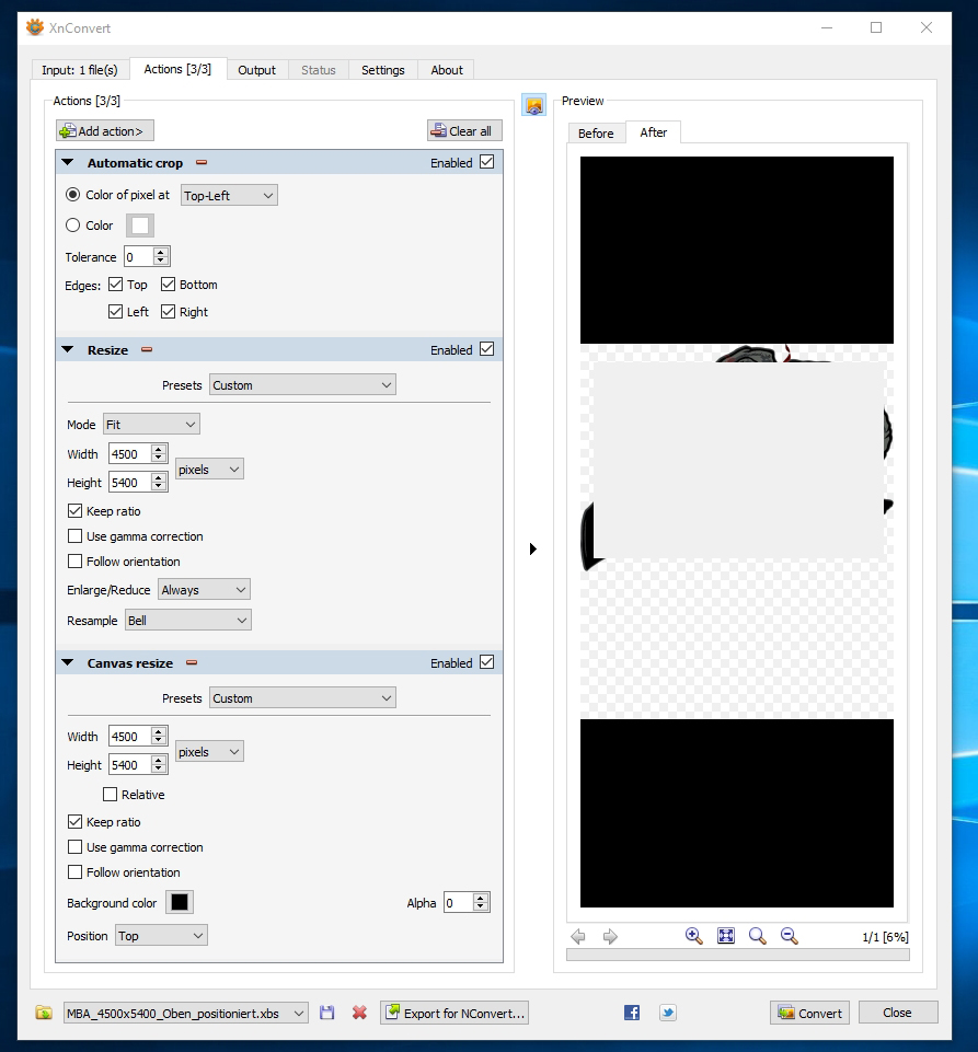

Hello I have a svg file that I want to position on a canvas of 4500x5400 pixel with the most possible
width of the picture what is possible with keeping ratio what I have reached with the first two actions
(you can see it in the picture).
Finally I want to position my picture in the upper area of the canvas but NOT on the highest top position.
I want to have a margin to the top. But in the Canvas resize selection box it's only possible to choose
Top, Top right, Left and so on.
So is there a possibility to set a margin to the choosed position?:
For example I choose position Top and 50 pixel margin or choose Left and 10 percentage margin.
Here a picture what I have done (rectangle over image because I'm not the copyright holder):

Thanks for inserting the file.
No I don't want to have the image in the black area.
I want to have it in the transparent area (the canvas).
But I want to have a margin to the top of my transparent area
and my image.
and my image.

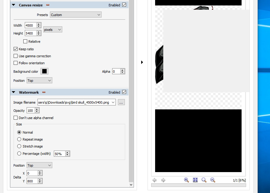

Yes, I find now a way to use the Watermark action and to do all in XnConvert,
but I have a problem with the Watermark action:
As step one I import my svg and do only the first two actions (Automatic crop and Resize
(Mode: Width, Width: 4500 pixels)). Then I convert to png.
At second step I import the 4500 pixel png (and height pixel ratio accordingly) that was created in step one.
Now I do only the Canvas resize (4500x5400 pixel) and the Watermark action.
But the last problem is, that the Watermark action doesn't work as I supposed:
In the Watermark action I set Position: Top and then to move away a little bit
from the top a delta of 800 for Y.
But instead of only moving my picture a little bit down I get a second picture.
You can see it in the second picture.
So why I get a second picture instead of only a moved down picture?
And how can I prevent to get a second picture?
First I do this with my svg file and convert it to a png file:
Then I import the png file I made in step one and do this two steps:

Yes, grey areas were to obscure because I'm not the copyright holder of the image.

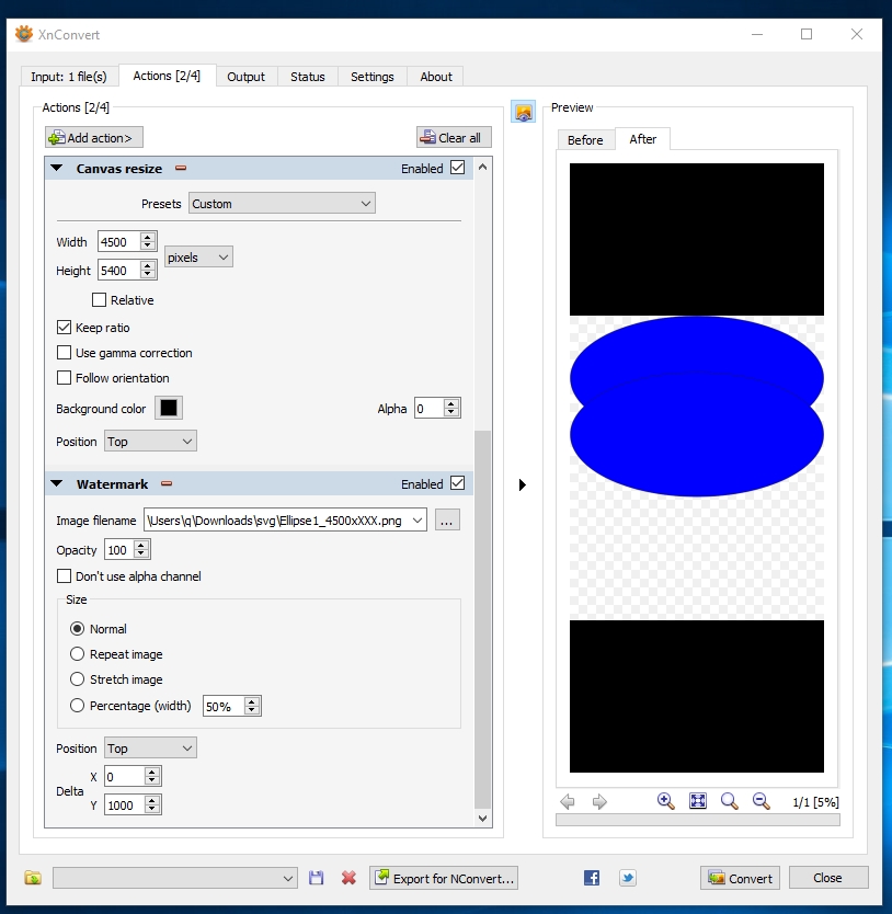

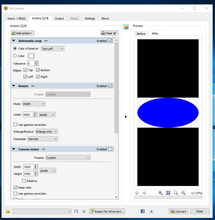

But I can show it with another example without obscuring:
In Illustrator I created an svg with an ellipse image.
As step one I imported it in XnConvert and have done the Automatic crop and Resize action and converted to a png file:
As new input I took the png from step one and done the Canvas and the Watermark filter:
I set a delta of 1000 for Y to move the image down from the top,
but I then get two images instead of one a little bit down from the top.
Ok, I think now I understand why this happens. Because the Watermark is a second image.
And only the watermark image can be moved around.
Or it would be great if there were a Delta setting also for the Canvas resize action in one of
the next versions of XnConvert.
So this should work:
Generate a full transparent image without an image in it with the dimensions
I want and use this as the input file for XnConvert.
Then in the Watermark action I import the image I created in the first step.
Now I can move it away from the top by setting a Delta for Y.
Then I click convert and have what I want.
