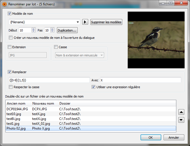

You can remove numbers with a "regular expression" (reg exp) in "Batch Rename" tool
You can see that {Filename} is used for the first step,
then numbers are found with the regular expression [0-9]
and these numbers occurs from 1 to 5 times : {1-5}
and they will be replaced by a X .. or anything else you'll choose.
Before processing, check the whole list for new names, because sometimes some files will get the same name (or nearly the same name : see the file testX_02.jpg ) or incorrect names.
