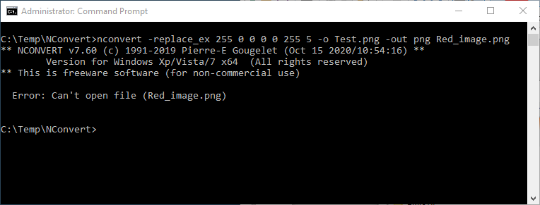

I tried with the attached file and get this:
C:\Temp\NConvert>nconvert -replace_ex 255 0 0 0 0 255 5 -o Test.png -out png Red_image.png
** NCONVERT v7.60 (c) 1991-2019 Pierre-E Gougelet (Oct 15 2020/10:54:16) **
Version for Windows Xp/Vista/7 x64 (All rights reserved)
** This is freeware software (for non-commercial use)
Error: Can't open file (Red_image.png)
Regards,
-HeiWo-

Now I get it...
The 'Red_image.png' must exist. After renaming from 'test.png' to 'Red_image.png' it works. The output is a 'Test.png.
