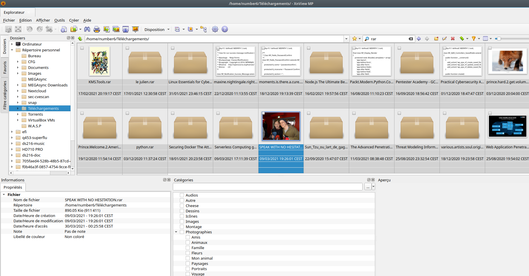

Joined: Mon Mar 29, 2021 7:20 pm
Re: Wrong Thumbnails
Post by rom »
Using 0.98.2 64bits on Linux, I see frequently wrong thumbails for .pdf & .rar files (thumbails are from pictures in the same directory).
Am I the only one ?
I'm attaching a picture with 3 wrong thumbnails - 3 pdf files.
Thumbails are thumbnails for pictures in the same directory.
For other rar or files there are no thumbnails - I guess this should be the correct behavior.
I solved the issue by removing XnView.db
