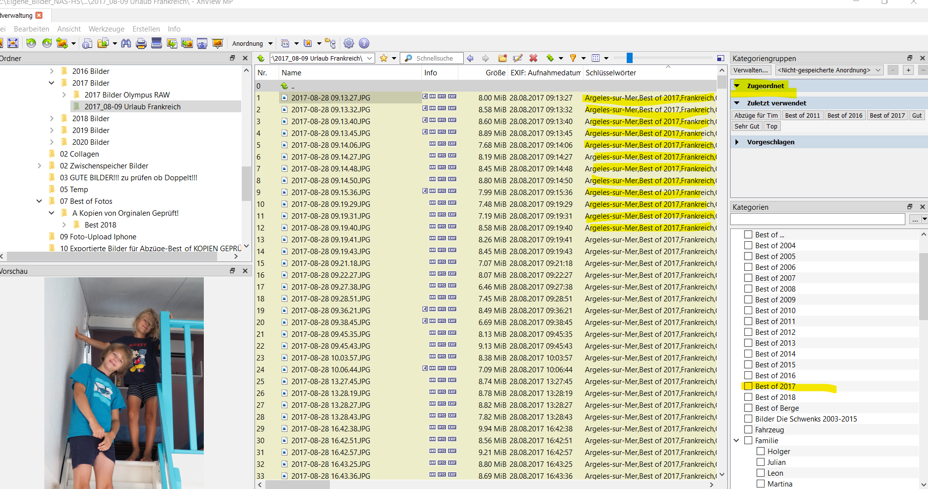

I am using XnView MP Ver 0.98 on W10.
in one of my folders after moving a large amount of images with keywords to it, I see the keywords in the list view for each image (see screenshot) but when I apply the category filter to a category none of the images appear. Also there are no keywords assigned in the category group (see screenshot).
What can I do?
Under Settings>Catalog>Catalog I already removed the folder and added it again!
What can I do?
