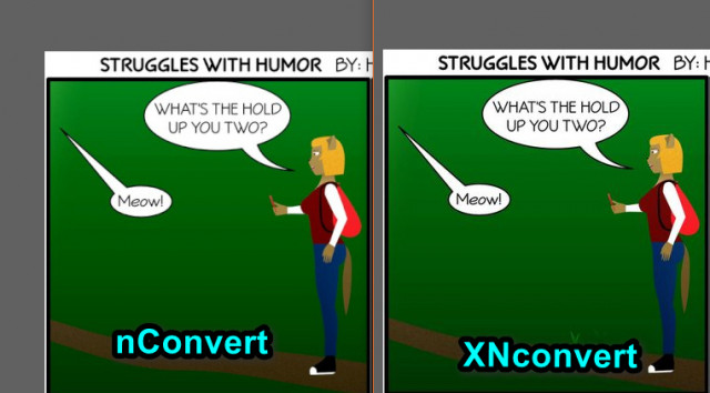

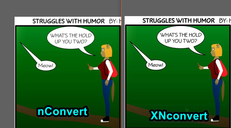

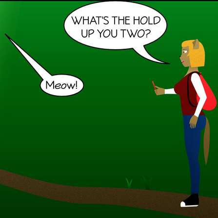

Hi, I am use to using Faststone Image resizer, but need to do resizing with bat files which it doesn't support.
When using nconvert however the image quality is substantially lower.
I've included a source attachment and the goal is to reduce it to 333px 333px [odd number's but that's just because this is a panel being taken out of context of a comic to avoid overly large images on the BBS]
Any help would be greatly appreciated.
Downsampled image has lower quality than expected

Could you post the code you are using?

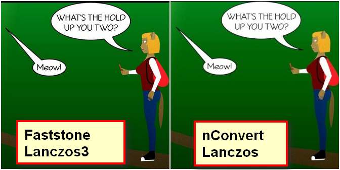

I don't have any immediate idea of what could be causing the quality problem, unless it is possibly simply the use of different JPEG quality values, but you do seem to be using different Lanczcos versions unless they are actually just different names for the same resampling method?
If you wish to experiment with different settings, you could possibly do it more easily using XnView MP GUI software, where you could change settings and see the result immediately... When I downloaded your source file and had a very quick look, the unsaved result seemed similar to your NConvert output.

yes they are different, as I can't seem to find Lanczcos3 in nconvert at least not using the -help command or readme files which seems to be the only real documentation.

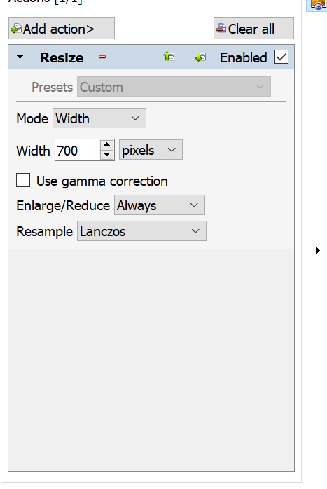

nconvert -out jpeg -ratio -rtype lanczos -resize 700 0 -o %%_SWH_W700_nuttytales.net.jpg "%~1"\
I don't need to do batches I need a single image to be automatically renaming and converted to different sizes for each new comic for all the different sties.
So I need to take a source file and than have it resized to about 10 different sizes all with unique names, which is why I want to use a .bat file to do it.

I just tired using XnConvert and it produced better quality than nConvert using the same settings?

'The default JPEG quality setting if the -q setting isn't used is 85 I believe, so that isn't likely to be a factor.
I can only suggest at the moment that if necessary you look for a workaround, the preview facility in NConvert (or XnView MP batch convert) provides a very convenient way to quickly test different combinations of loaded actions... I have sometimes seen a filter such as 'Enhance focus' or 'Soften' enhance the subjective appearance of images with small pixel dimensions.

I'm surprised, as normally there wouldn't much if any visible difference in image quality been 85 and even 100, just a fairly large difference in filesize, but you are working with images with small pixel dimensions.stickynoteme wrote: Mon Jan 11, 2021 10:31 pm This turned out to be the -q flag. I didn't realize that faststone defaulted to a higher than nConvert setting them to the same here produced roughly equal quality.
On the assumption that Lanczos3 is better than Lanczos, I was going to suggest that you try finding the Lanczos3 plug-in in Faststone, and then try using it in NConvert, suitably renamed and with the NConvert plug-in disabled by, for example, renaming it. That would require that both plug-ins are the same bit depth, NConvert is available in either 32-bit or 64-bit versions if needed. Or maybe it can be downloaded directly?
One reference from a quick search: Lanczos3 algorithm as a way to produce better image downscaling.

stickynoteme's source.jpg converted to PNG and downsampled from 447×447 to 333×333 pixels with…
- XnView Classic (Bilinear + Lanczos)
- XnView MP (Lanczos)
- XnConvert (Lanczos)
- nConvert (Lanczos)
- PhotoFiltre (Lanczos)
- IrfanView (Lanczos)
- FastStone Image Viewer (Lanczos3 + Lanczos2)
- Photoshop CS2 (Bicubic + Bicubic Sharper + Bicubic Smoother)
