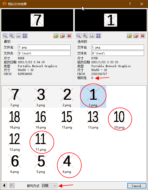

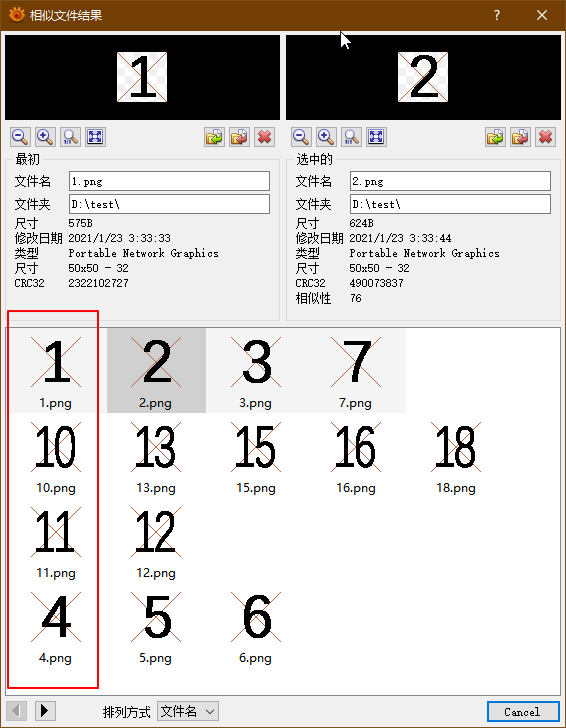

XnView: MP 0.98.1 - 64-bit
OS: Windows 10 - 64-bit
Effect: Similarity value is 0

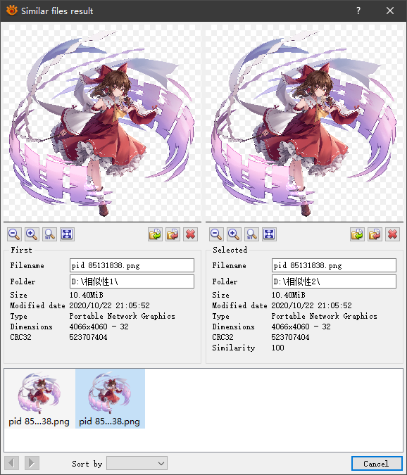

  • Tools - Search similar files - Similar files content
  • Normally, the similarity is 100

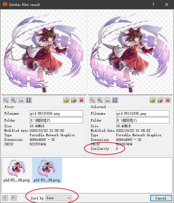

  • When you use date sorting, it becomes 0 :bug:
Expected behaviour: Similarity value is 100.

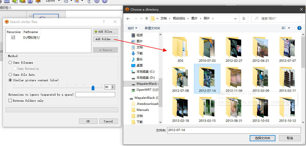

It is highly recommended
  • Allows multiple folders to be selected at the same time.
    Currently, only one can be selected. It would be more cumbersome if I just wanted to compare a part of folders.
    Many add folders button have this problem. Such as in Batch Convert, Join Images.

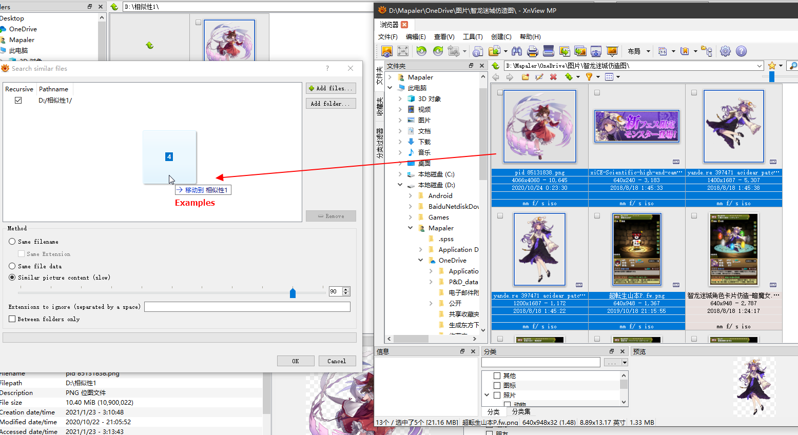

  • Allows me to drag files/folders into the list.
    Can't drag at the moment, it's cumbersome to specify a file.

xnview wrote: Mon Jan 25, 2021 1:19 pm could you send me the sample files?
You can use any similar picture. If you really need it, use this.
download/file.php?id=7069

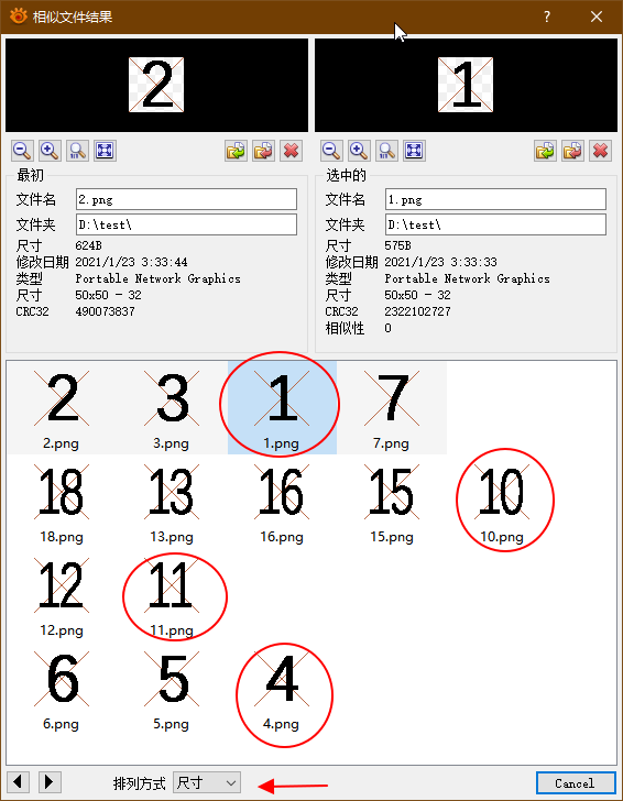

I found a law, Sort by date, is the last of each row, with a similarity of 0.
And then sort by Size, are the same files (but not same order) with a similarity of 0.
Back to the default sort, you can see that it's actually the first by default.
Posts: 48092
Re: 0.98.1: The wrong Similarity value
The reference item must not changed after sorting
Posts: 48092
This problem is supposed to be fixed in XnView MP 0.98.2. Please check and confirm the bug fix here.
