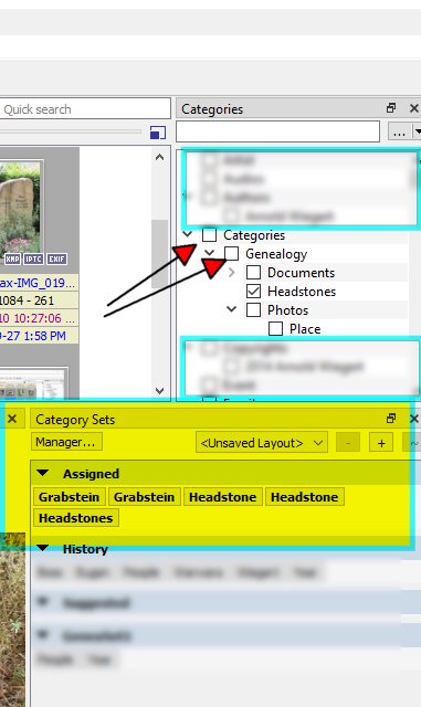

I has been a while since I last used XnviewMP (XvP) to add category data to some of my images and now that I have come back to trying to review that data I am a bit puzzled. FWIW, I am now working with 0.98.0 under Win 10 64-bit (updates are current)
Last time I worked with XvP I saved my category tree and it seems intact now in the Categories pane at the top right.
When I select one of the images (jpg) I see the categories and other data I had entered at the time in the lower left pane, in either the IPTC-IIM, XMP or Exiftool fields, as I would have expected.
What I am not seeing is these categories selected and marked with a tick mark in the 'Categories' tree, nor listed in the bottom pane Categories Sets -> Assigned
I am as sure as I can be, that I assigned categories from the tree to specific images by clicking the appropriate check box in the tree. The data was written to the image when I changed images and all of the check boxes corresponding to the assigned properties would be checked again when I selected the same image again.(The necessary check boxes in Tools -> Settings -> Metadata -> IPTC & XMP are set as needed for this to work)
That is not happening now for data already in the images when XvP starts up (i.e. none of the corresponding check boxes are selected), though the check marks appear/disappear as expected for newly assigned/deleted categories.
Same goes for the 'Assigned' list.
That the 'History' and 'Suggested' lists are empty at this stage is unsurprising and understandable.

could you post a screenshot?

Re: Categories panel/tree data not updating at startup
Since the images refer to people in a genealogy environment, I have blurred certain details.
If that is a problem, I can provide more details, but off-line to avoid privacy issues.

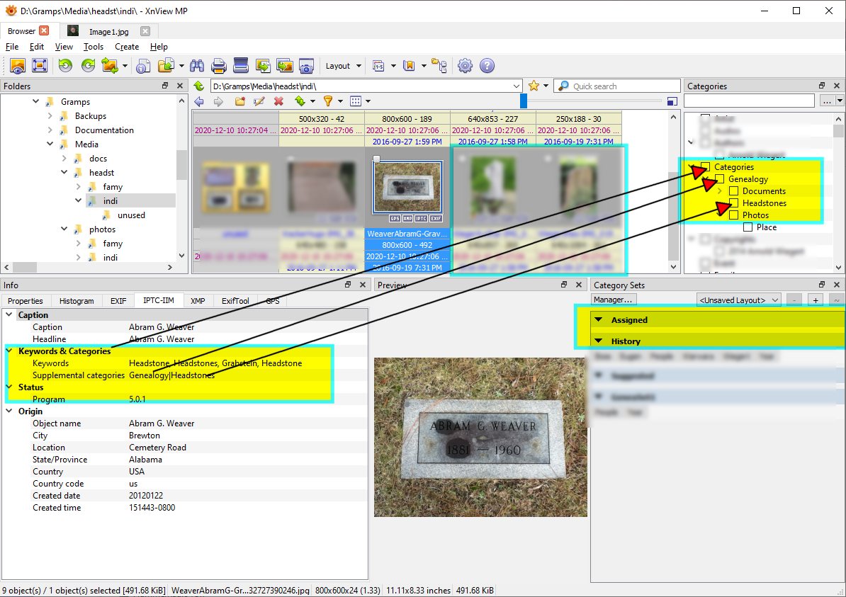

could you try to select the file and View>Update catalog from files?
Executing the commands you suggested does give me some of the expected results, including _some_ of the keywords as well as filling in the 'Assigned' list as far as I have tested the data at this point.
2 issues:
1 - not all check boxes back up to the trunk of the tree are selected
2 - is there a way/option to have the 'update' happen when ever I switch to a new image
#2 is the more important issue. Though, for the time being, I can work around that.
#1 is something I now have to investigate further to see how it relates to my 'category' tree setup in my supporting text file and how it may relate to duplicate strings in the 'Assigned' list
2 issues:

- Posts: 1588
it seems that you have lost the functioning of the database (the catalogue), perhaps because the photos have been moved, or the functioning of the "new" xnviewmp is no longer in line with the old catalogue.
To re-establish this link between the keywords and the catalogue, you can use the "add" button in "settings, catalog", this feature can update whole foders and subfolders at once; but first you have to enable correct settings in "settings, metadata" pane, in order to import keywords.
There are hierarchical categories in your screenshot , and your iptc keywords seems to be not hierarchized (= flat)
It's not always easy to handle hierchical categories with IPTC keywords, I choosed XMP LR Hierarchical keyword for this task.
And I don't think that xnviewmp would be able to read flat iptc keywords and fill hierarchical categories . (Pierre ? )
To add parent categories, you can enable 'auto apply parent keywords", and uncheck / check children category .
To do this on a large amount of photos, use categories filter, select a category, select all photos found, uncheck (wait a while ) /check category , and unselect photos (before doing anything else)
Whether the DB interface has changed, I can't be sure. There have been a couple of updates since I added the data to the test image.
It is even possible that I modified the Categories structure. A detailed change log or version control would be very useful, but I have not figured out how to accomplish that.
As to the way XVP stores the hierarchy, I am unsure, but dumping the XMP data gives me, among other things:
Whether that represents a 'flat' hierarchy, I have no idea, but I assumed 'hierarchicalSubject' was/represeted a tree.
It appears, that XVP chose to save the data in Xmp.lr.hierarchicalSubject
Where would I find the options to adjust:
Xmp.dc.subject XmpBag 4 Headstone, Headstones, Grabstein, Headstone
Xmp.MicrosoftPhoto.LastKeywordIPTC XmpBag 1 Headstone
Xmp.MicrosoftPhoto.LastKeywordXMP XmpBag 1 Headstone
Xmp.iptcExt.PersonInImage XmpBag 1 Abram G. Weaver
Xmp.lr.hierarchicalSubject XmpBag 4 Keywords|Headstone, Categories|Genealogy|Headstones, Grabstein, Headstone
As yet I have not tried to the 'fix' you suggested, but will have a better looks at the procedure now.enable 'auto apply parent keywords", and uncheck / check children category

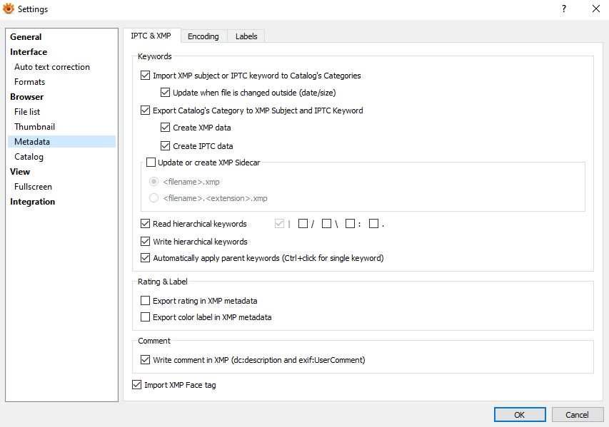

- Posts: 1588
>settings > metadataWhere would I find the option (...) auto apply parent keywords

- Posts: 58
- Joined: Thu Apr 06, 2017 9:29 pm
Here is what the dialog I believe you are referring to looks like in my version (0.98.0 )XVP
Unless you are referring to 'Auto.....parent keywords" which is checked

- Posts: 48912
In the example sent, the picture has Headstone, Headstones, Grabstein keyword but not Categories & Genealogy
- Posts: 1588
This option takes effect when you unmark/mark children category , and release selection.Unless you are referring to 'Auto.....parent keywords" which is checked
This method can be used to "repair" missing parent keywords.
