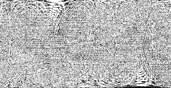

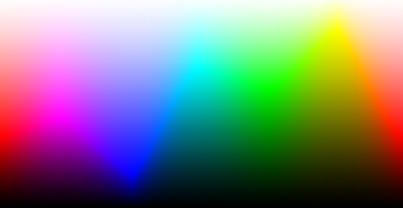

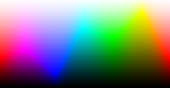

:-D I was hoping for something like this to be implemented, but I can't get it to work.
How do I tell nConvert to compare (the blue channels of) two images (original.png + edited.png)?
Could you please give me an example illustrating the purpose of the method argument and what values (red/green/bue? red_only/green_only/blue_only/alpha_only?) are accepted as parameters?

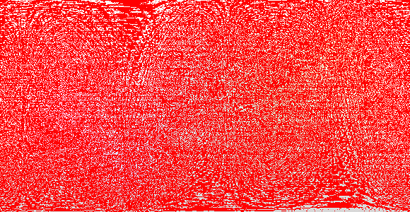

you can try
only red/red_only as parameters
