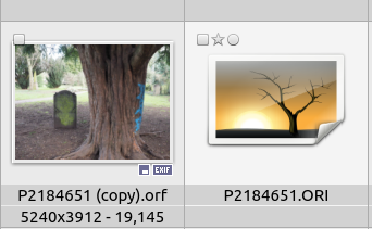

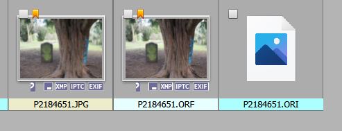

The first image of the eight is also saved as an ori file. This is a regular sized raw. XnView does not display the ori files when Settings, Custom, Images is ticked. I can force the display of the ori by adding 'ori' in to the include line. XnView now displays the file but not the thumbnail (at least, it uses what appears to be a default image).
Given that this is a newish feature of Olympus cameras I can understand that XnView does not support this file (I understand that the file is normal, it is just the extension that is not). Is this a candidate for a new feature request?

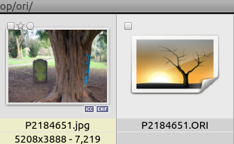

Same here (Ubuntu 20.04 + latest XnView MP)

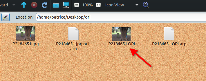

It appears that
ART opens it like a charm (ART is a fork of Rawtherapee) and sure Rawtherapee does it
Photivo opens it as well
Darktable also
Lightzone cannot...
But my Desktop recognize it (MATE Desktop) :D
The good thing is when I double click in XnView MP on that .ori file ART automatically opens it :D

roadcone wrote: Fri Mar 05, 2021 9:56 am Yup! Agree. What I didn't try is simply changing the extension from ori to the regular orf. If that worked then it would be the case that the file is (largely) the same and that it is only the extension that is not recognised. May try that when I'm back on the photo laptop.
It does work! I only made a copy and renamed it as .orf and in Xnview MP it shows the proper image, size, etc :D

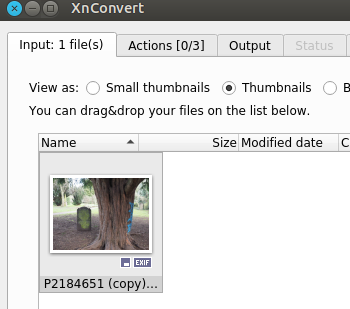

Also with the renamed extension XnConvert (the app itself) can now export it to .jpg without throwing an error and shows the proper thumbnail and data in the input tab.
