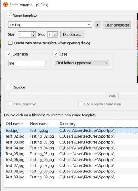

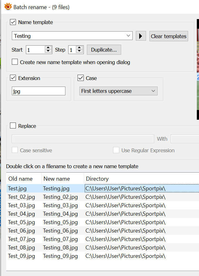

I am running XnView MP Windows Version 0.98.3 32bits (May 6 2021) and I am having problems batch renaming files.
The issues are that when I select 1 as my start number with an increment of 1, the first file in the batch is not numbered to 1. See below.

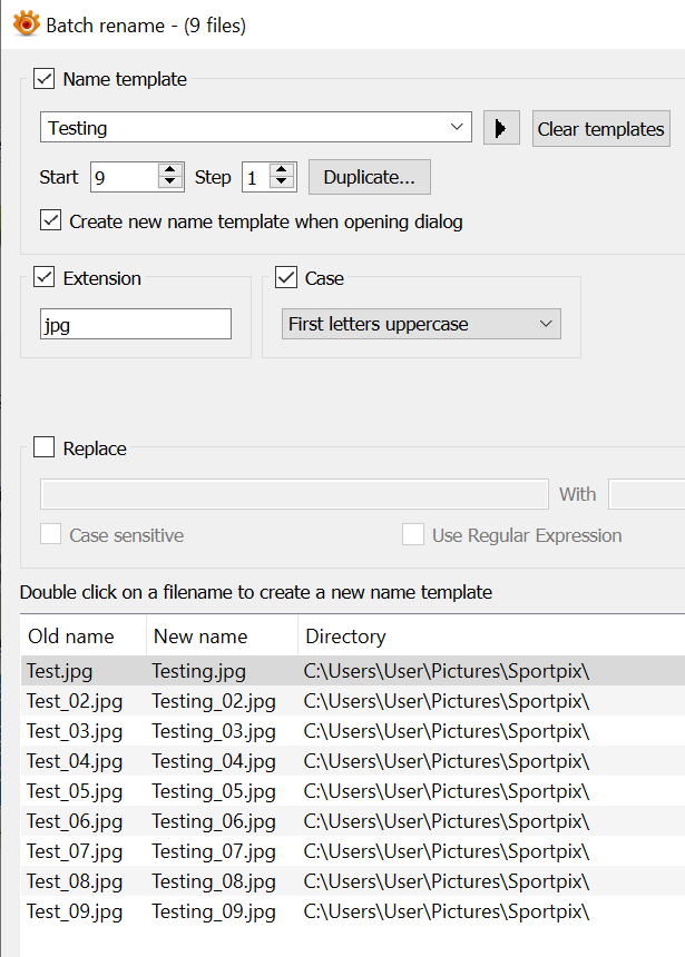

Then when I try and renumber using a starting number of 9 with an increment of 1, it does not change the names at all. See below.
I am doing something wrong or misunderstanding the logic?

You should try like this "Test_##.jpg"
# - 0-9
## - 00-99

hello I have this problem too. If I want to add pictures to an excisting batch I need to start the numbers with the first new one ( as seen in the screenshot with the 9) but is doesnot change the consecutive numbering and still starts with no number and then 2. The proposal with using ## in understanding is for creating a template.
I hope I could explain my little problem and maybe somebody knows a solution.
# - 0-9
## - 00-99
The numbering only works if you add a numerator.
Otherwise how the software can know where to put it and what format.

Thanks Franky,
I got it now and it works! Great and quick help :D
