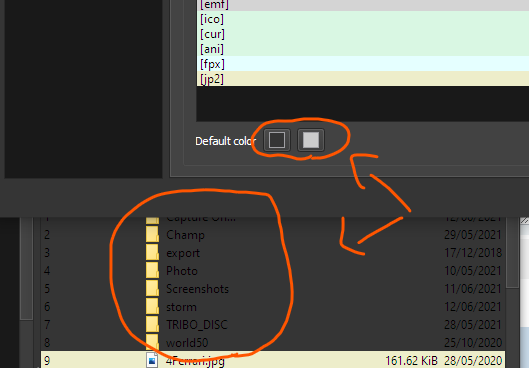

=> the file list font is set to a black, and are pretty much unreadable (screen_1)

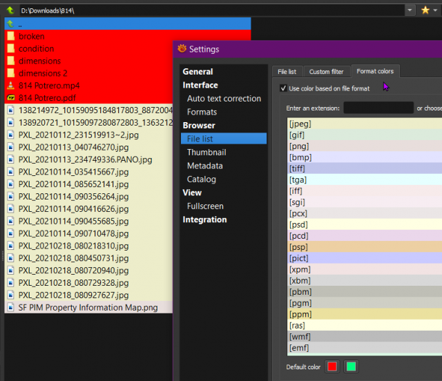

Possibly related bug:
1) In the "Format Colors" dialogue, enable "Use color based on file format"
2) Change the "Default color" colors to (for example) red background and green foreground
=> the background color seems to be set properly, but the foreground text color seems to be ignored. (screenshot_2)

you need to change foreground color for each extension (which use black as default)

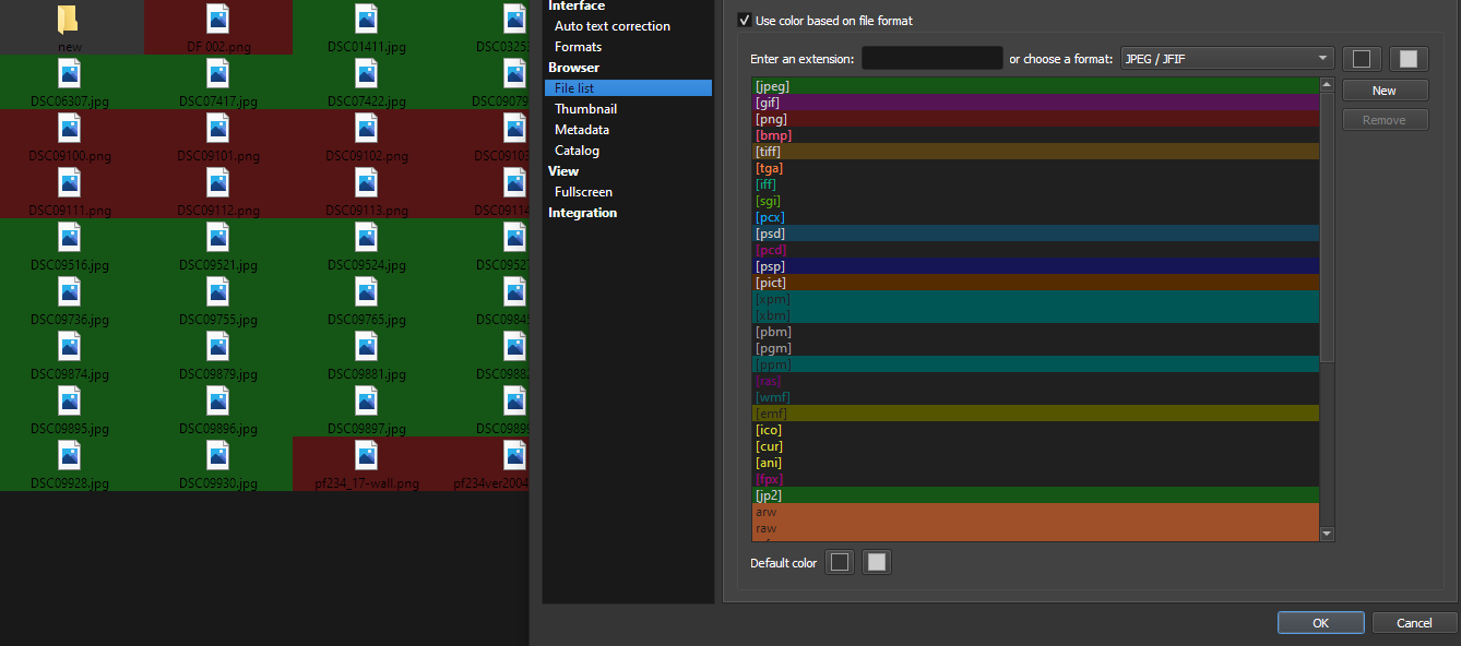

Came here for the same issue with the foreground color. It's completely ignored.
I'm using XnView MP in a dark theme (Fusion Dark) but since the foreground color is ignored it is always set to black, forcing users to pick a light color to create contrast.
And using the light color defeats the purpose of a "dark theme" as every time any option other than the thumbnail variants is selected, the whole screen becomes bright (as all the files must have a light color).
I'm uploading another example to demonstrate the same.
Hope it's clear what's the issue. It's simply ignoring the selected color.
EDIT: evidently, I'm not using a light color here in the picture, but if I want to read clearly, I have to.

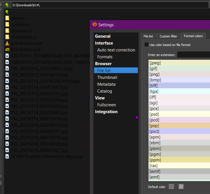

Ok. No foreground color is respected.
I just tried changing them and this is the result (attached file).
(Edit: notice how JPGs and PNGs are supposed to have light text but they don't)
