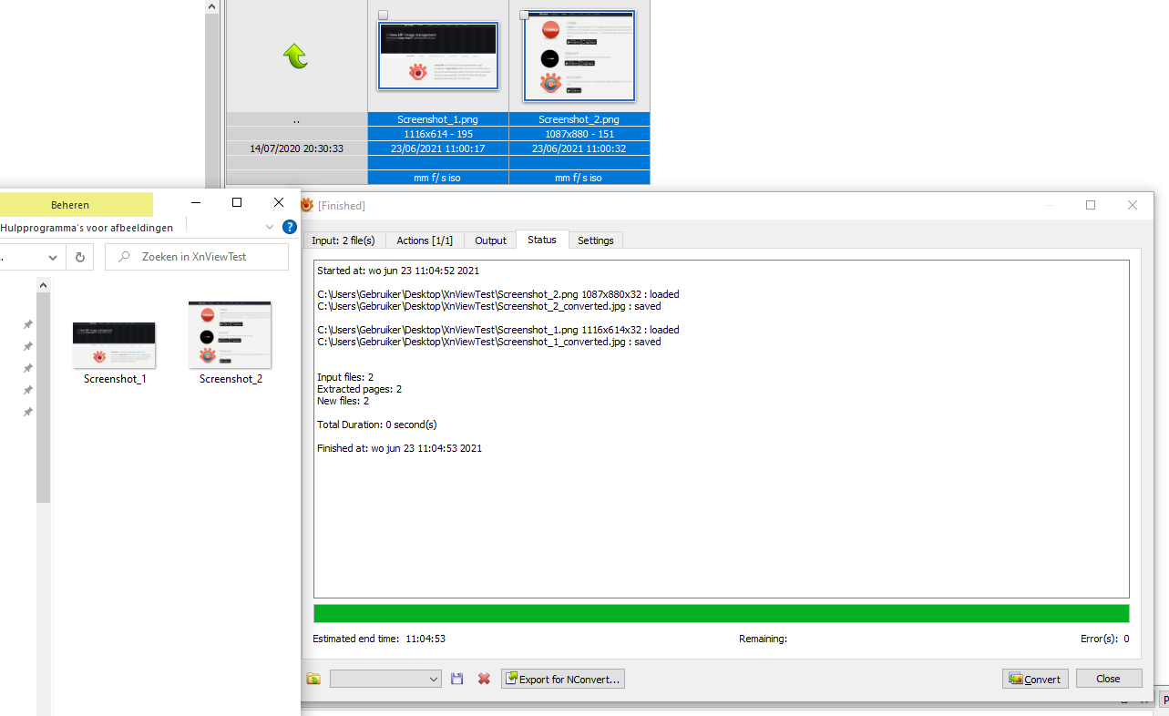

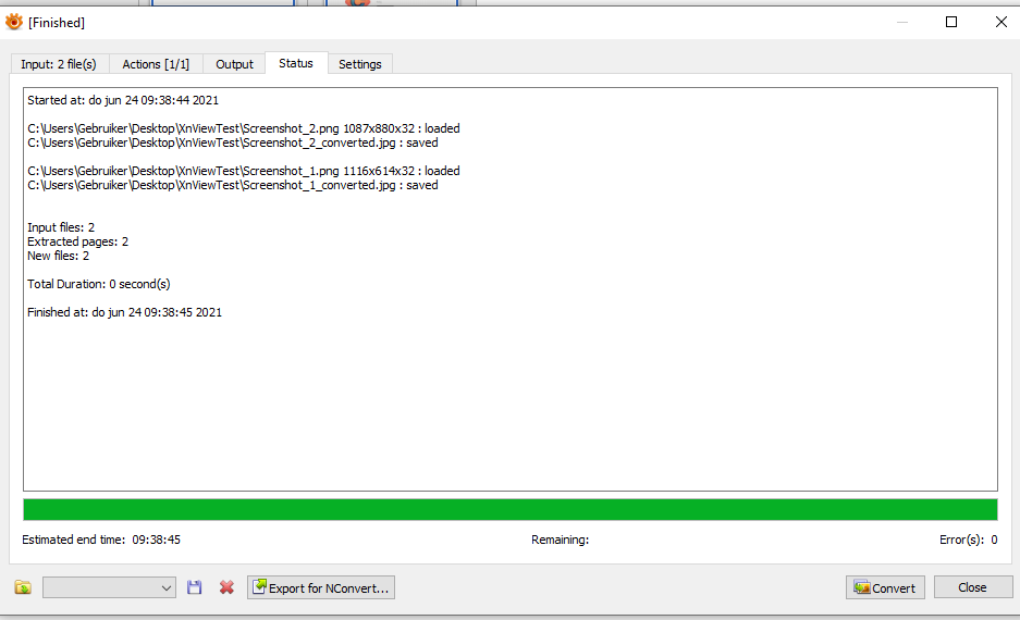

Re: Batch convertor resize not saving converted files - 0.98 64bit
Hello Pierre,
Here is the screenshot of the status tab.
It mentions the files are saved, but they are not on disk...

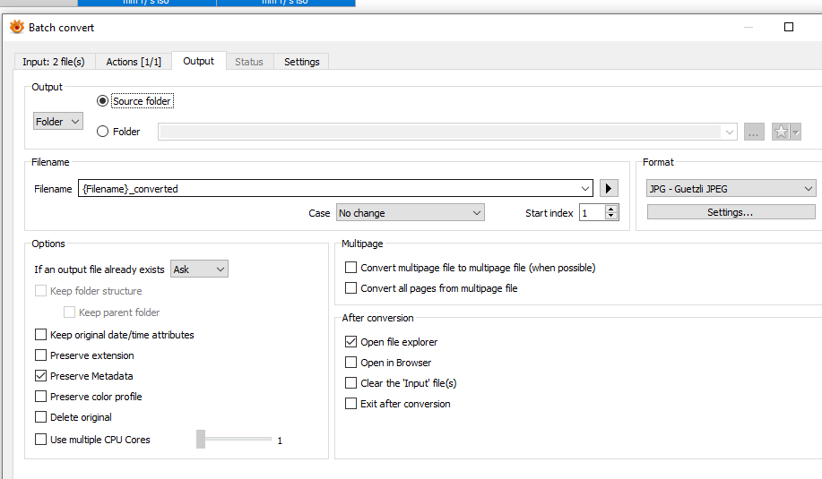

Your problem may be that you are saving to JPEG Guetzli format which can be *very* slow to produce an output; the format is not really suitable for everyday general use for larger images.
But the status tab does show an output being produced, you might try outputting to a standard JPEG format to test.
I switched to a different JPG: It worked!!
Great!!
So I notice the output is A LOT FASTER too.
But this means that using Guetzli, the output seems to be generated (because the processing happens) but the result file is not written (on my machine).
Might there be a bug using that format?

- Posts: 47866
There is currently a problem with JPEG (Guetzli) and large image
