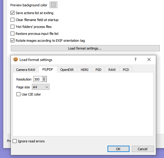

The settings for PS/PDF say: Page size A4. But XnConvert seems to ignore that.
If both the DPI and page size are determined that will define the image pixel dimensions; I'm not sure if then resizing the image to a file size would be compatible with that, in general I think not, which could explain the results you are obtaining. But I don't know, initial thoughts...

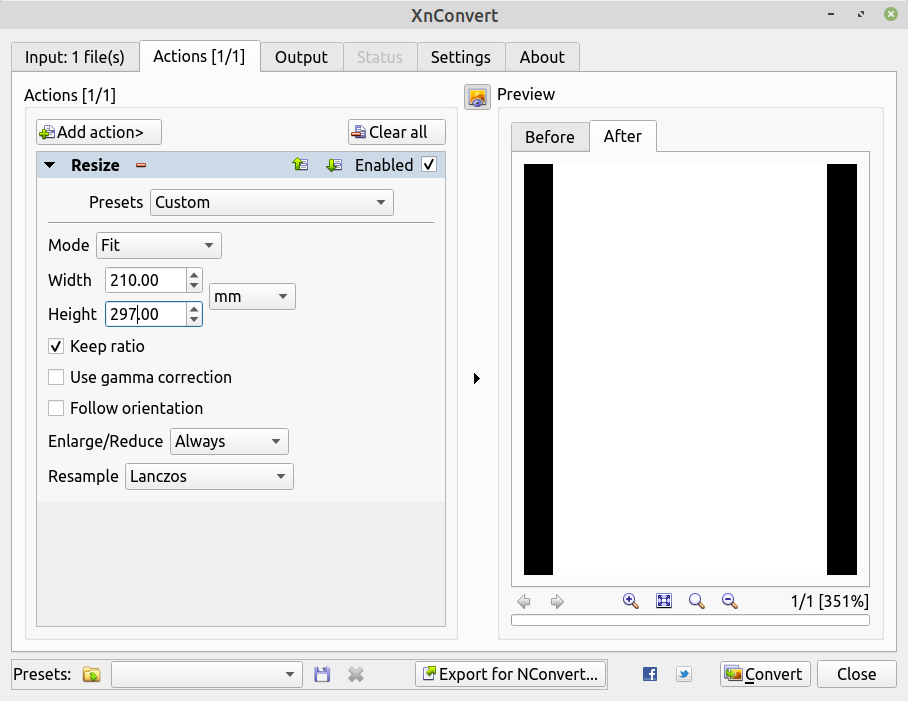

I see that the Resize dialog has a Custom option that can be set to A4 mm dimensions:
Have you tried that option, I imagine you would have to ensure that setting isn't overridden by your Output tab settings.

Yes, I tried that - and there must be at least one bug: settings like 210 x 297 mm lead to 21 x 29 mm pdf files, with a very low resolution, not readable.
Settings like 2100 x 2970 mm lead to the correct paper size of 210 x 297 mm, but to very large files. (50 KB --> 1 MB)

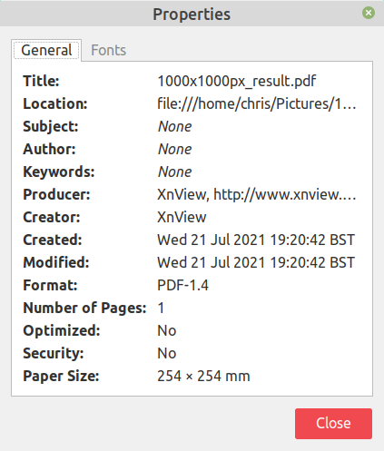

My test image files had a size of 10"x10" as those were easy dimensions to test, since DPI is expressed in Dots Per Inch.XnBoy wrote: Thu Jul 22, 2021 6:32 am Ok, but are you sure this changes the PDF paper size? On my system, it does not.
The properties of my output 10"x10" (254x254mm) PDF file with a reduced filesize display as follows:
The 'Paper Size' is unchanged but the filesize is reduced.
