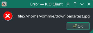

when I try to open a file with the associated program, the following dialog appears:
Error - KIO Client
In the terminal, XnView outputs the following log line:
## onItemPressed
kf.service.services: KApplicationTrader: mimeType "x-scheme-handler/file" not found
Exaclty the same log entry appears when I triy to open the file with the context menu entry "Open in file explorer", with the same error dialog (but for the path).
It seems the mime type is wrong as it is just 'file'? If I open the file (or others) with the default file manager (Dolphin) or with xdg-open in the terminal there's no problem.
