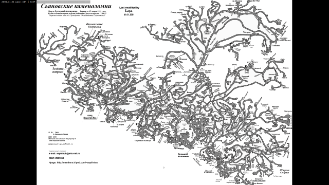

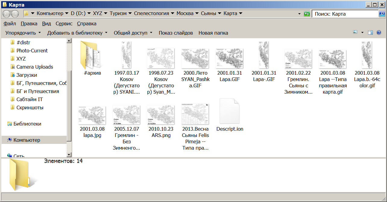

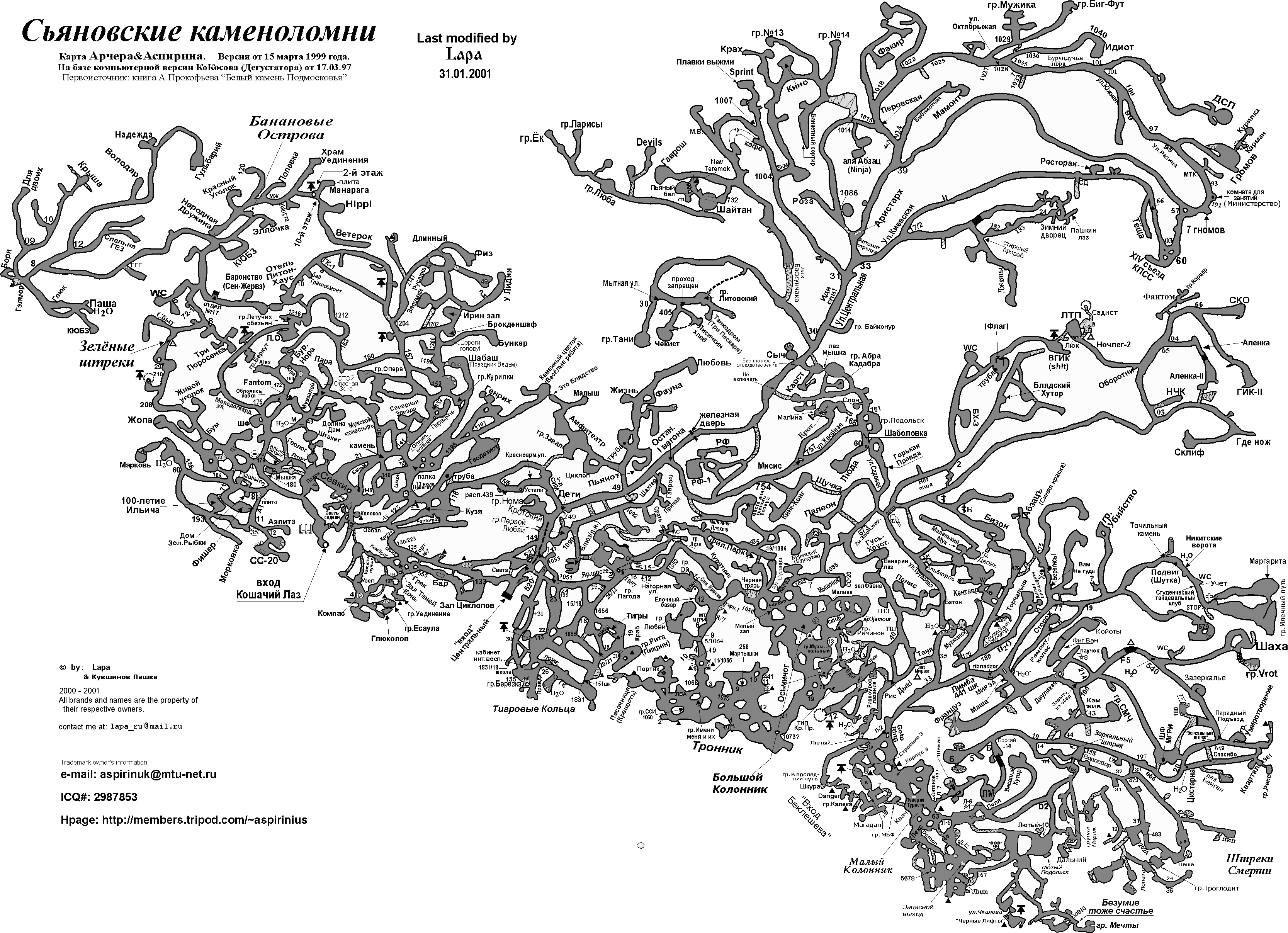

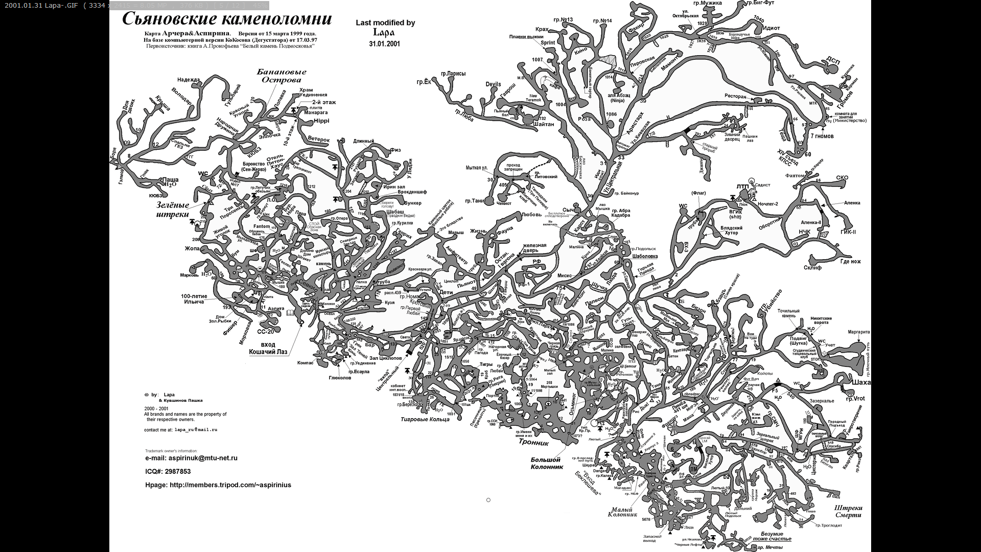

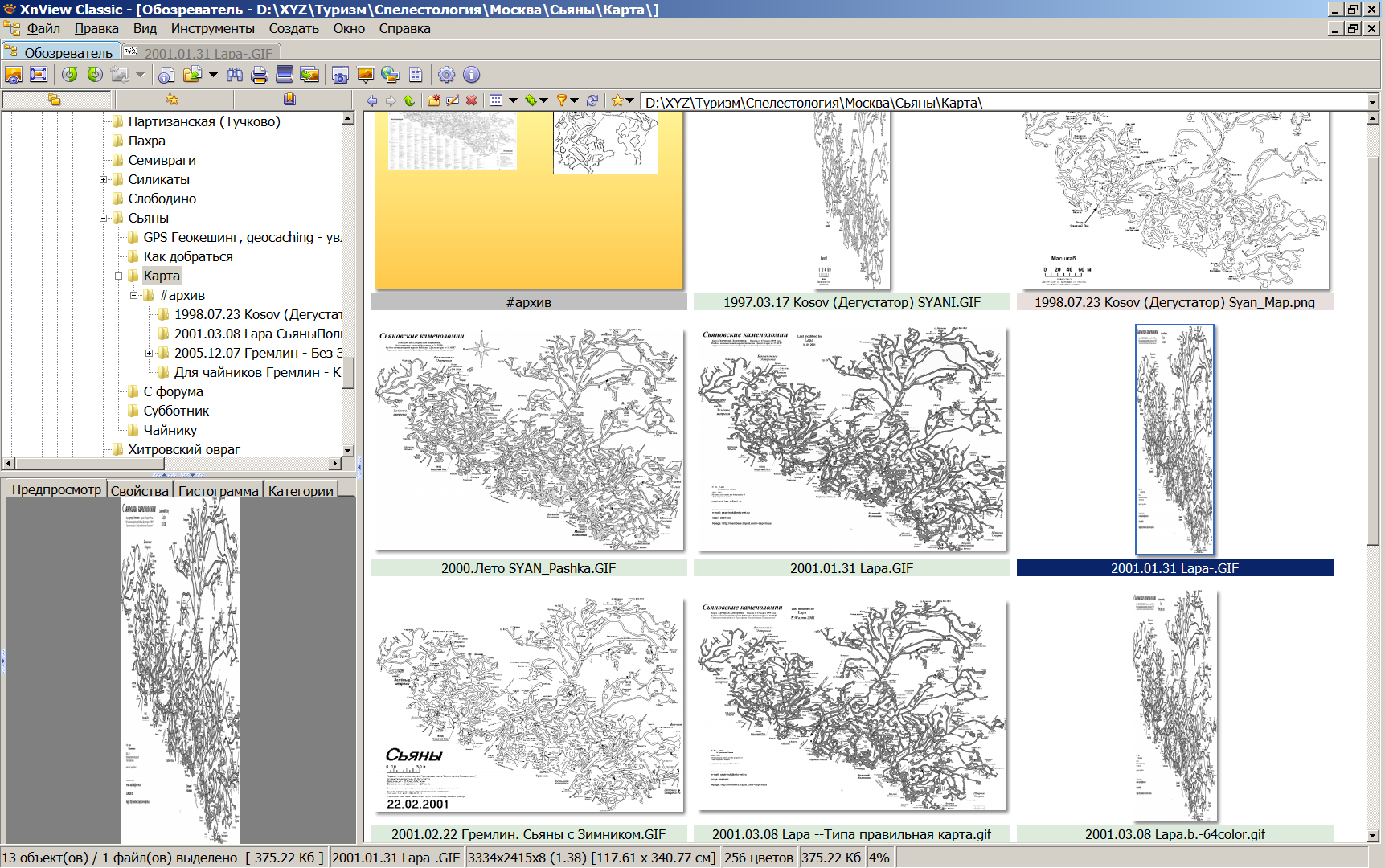

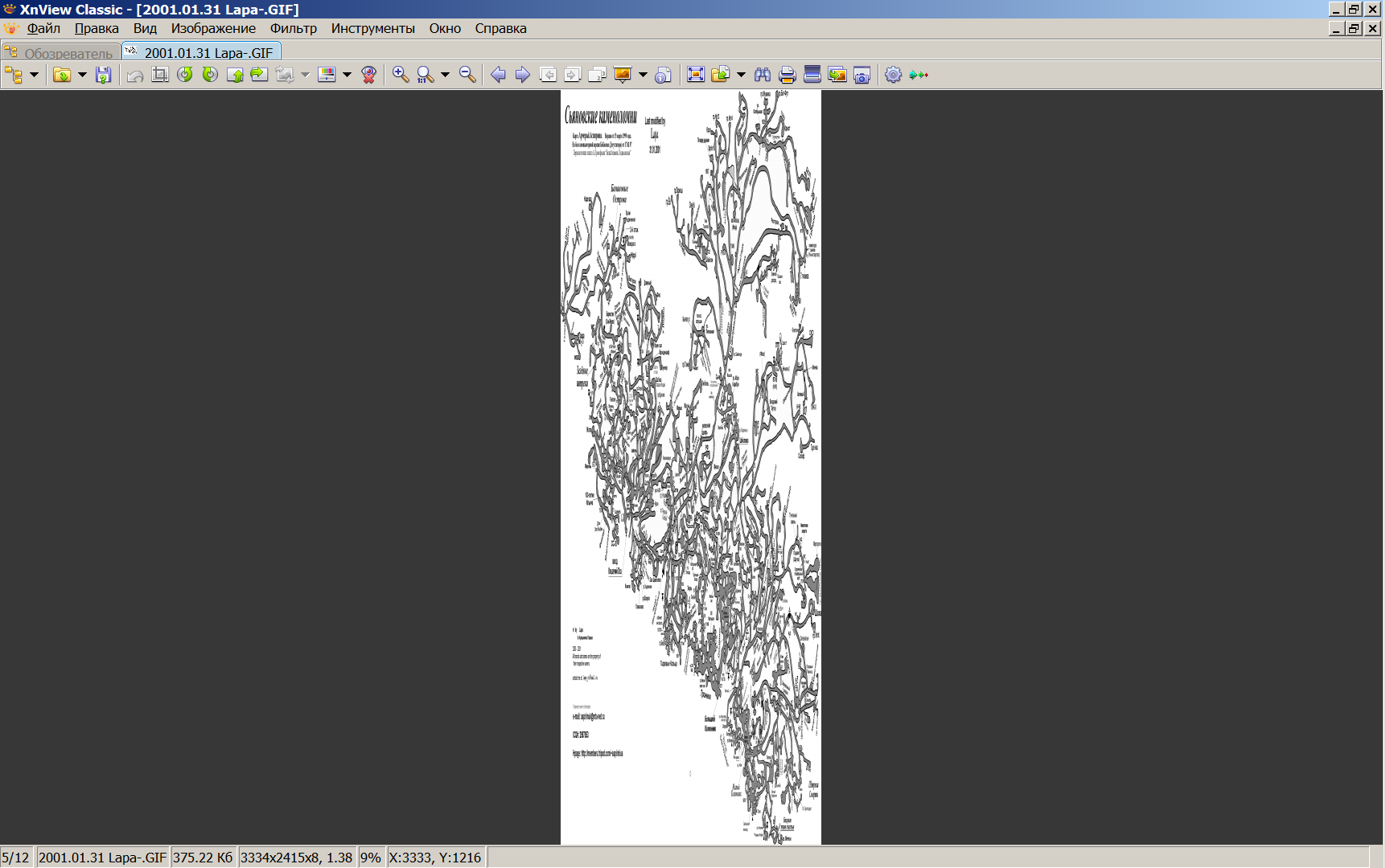

XNView 2.50
Some GIFs displayed as GIF flattened.
Problem
Problem

According to XnView, your sample has different DPI values for X and Y (72×18). Adjust zoom if X/Y DPI are different in ToolsSettings…GeneralGeneral usually takes care of that. It makes no sense that the sample file is displayed correctly, if this option is turned off :-?
