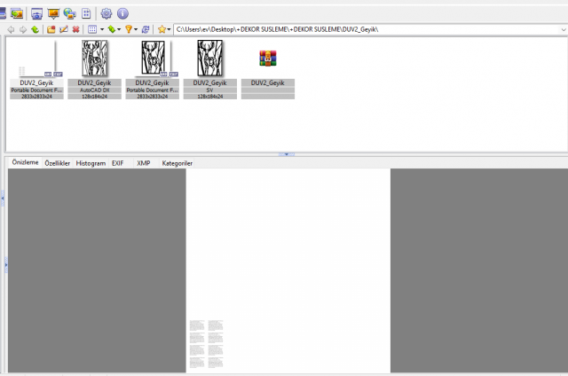

Hello everybody. ı am newbie. xnview classic works very well. I just couldn't get the .ai extension to work. How can I run the .ai extension.

When open some .ai file, it display a "warning message image", instead of the actual image. (you can see the waring after zooming in, like the screenshot at below)
The warning ask the .ai file to be saved with pdf "PDF compatible".
