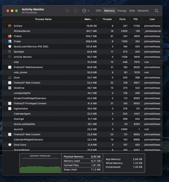

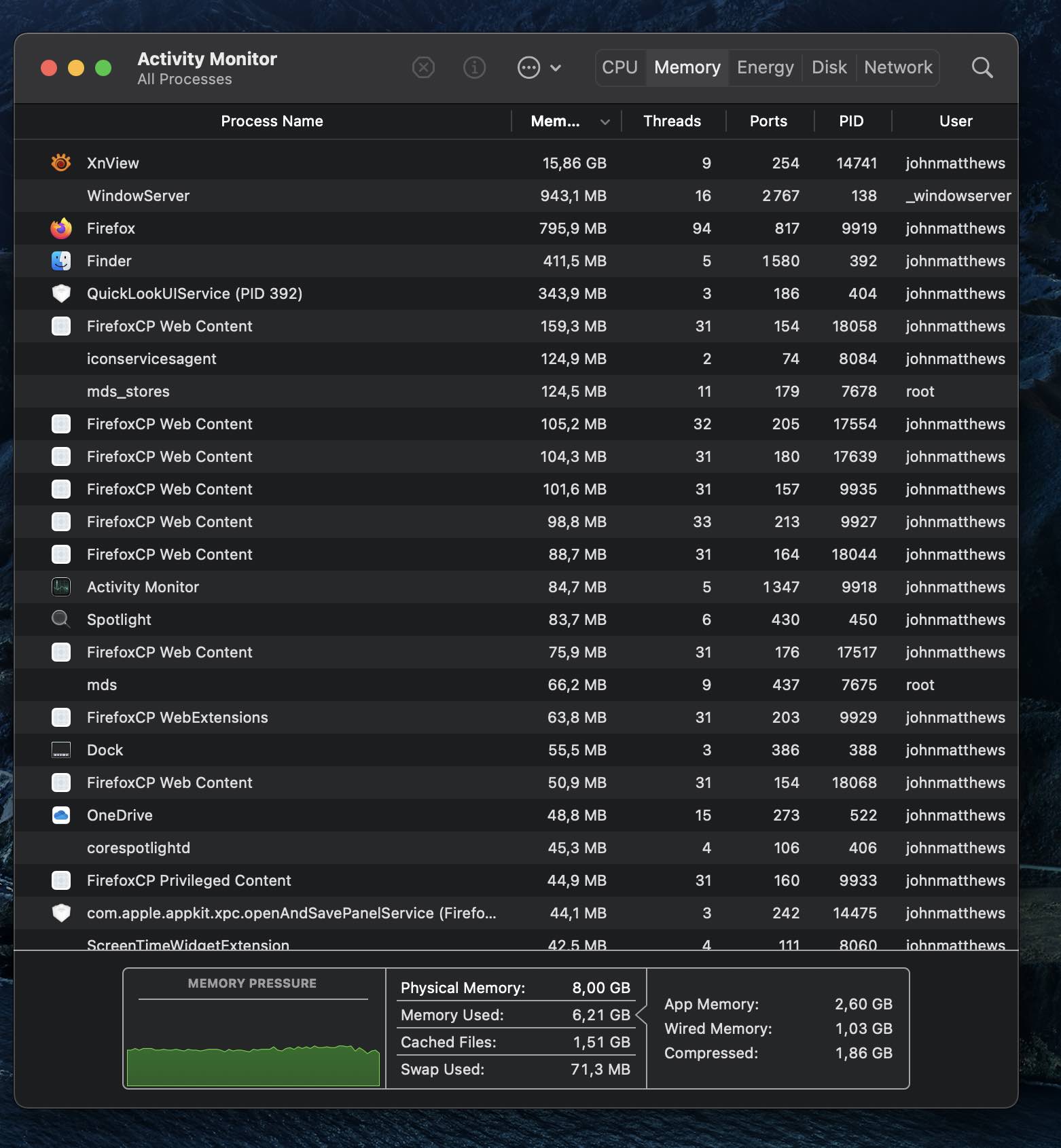

Upon performing a Batch Convert of some 500 images, I noticed excessive usage of memory. If I convert too many images, I eventually get a message asking to force quit an app to create more memory. Below is an screenshot of the memory usage:

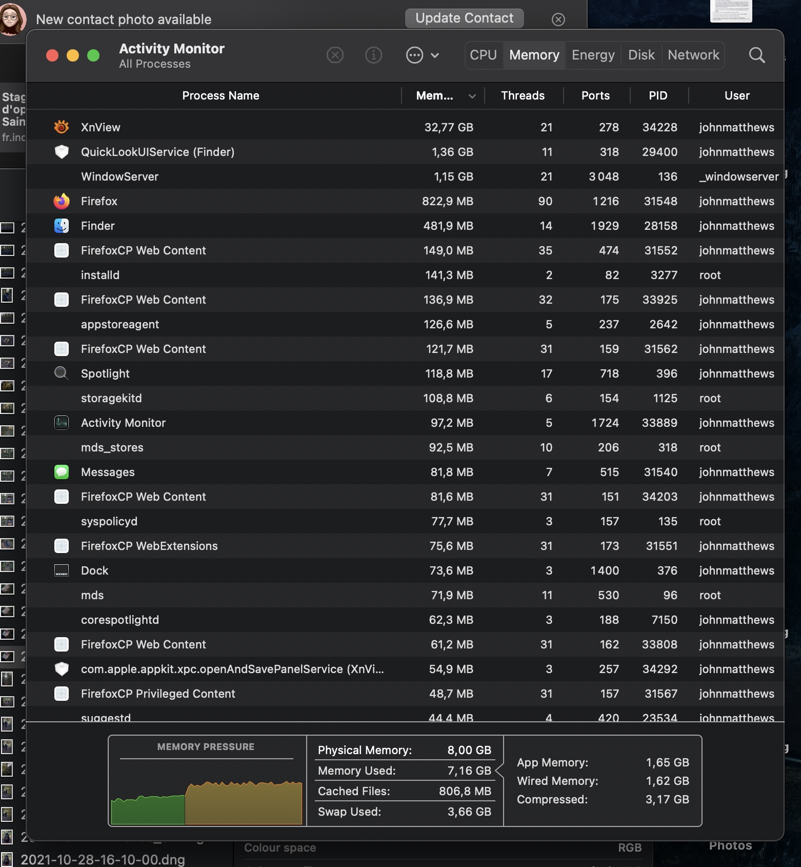

I should have added that it ended up using 34GB of memory and the ONLY way to lower the memory usage was to quit the app.

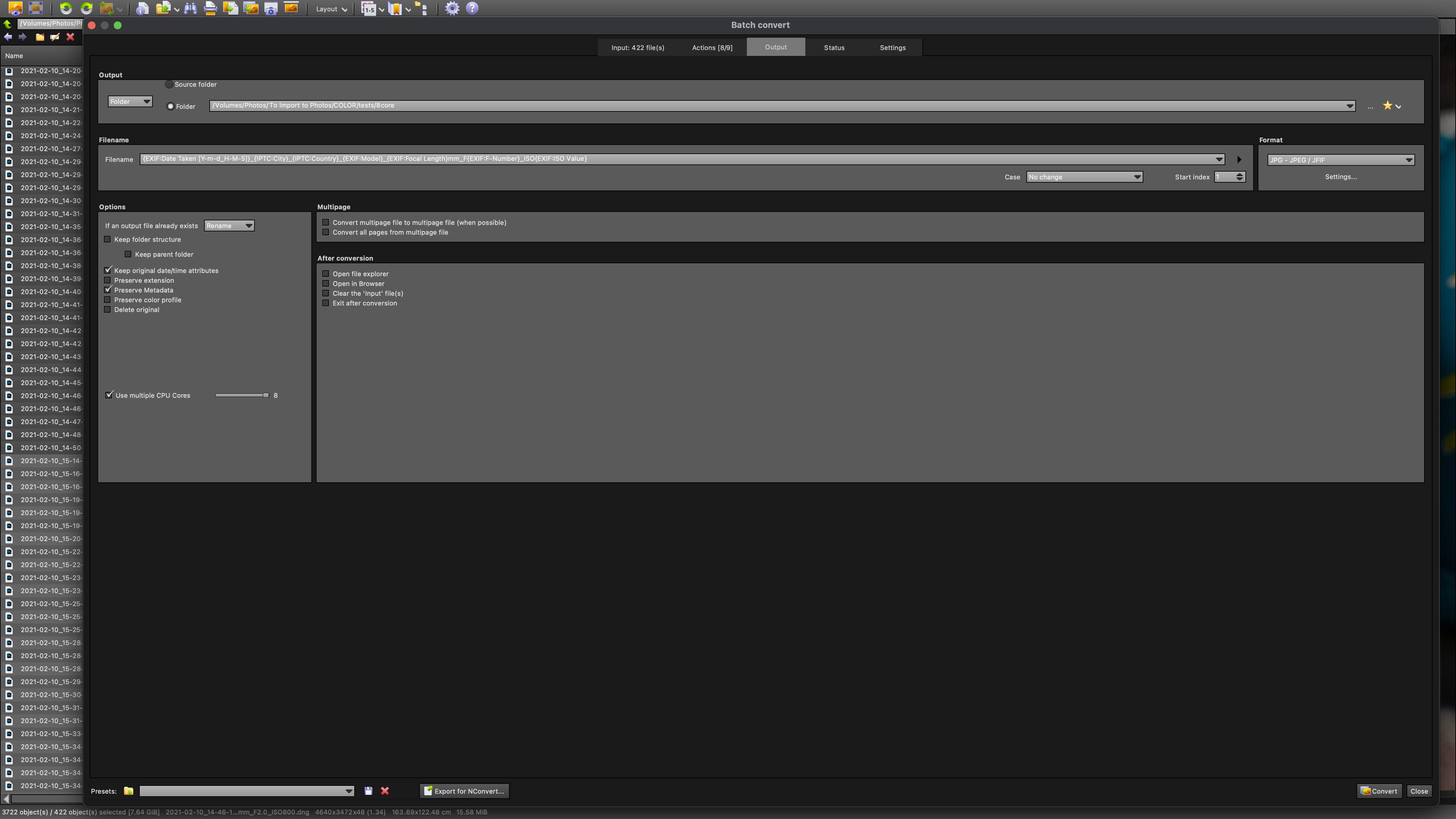

Here are my exact settings for the RAW export:
I think this happens only with RAW files. I tried with only jpg and was unable to reproduce it (multicore selected).

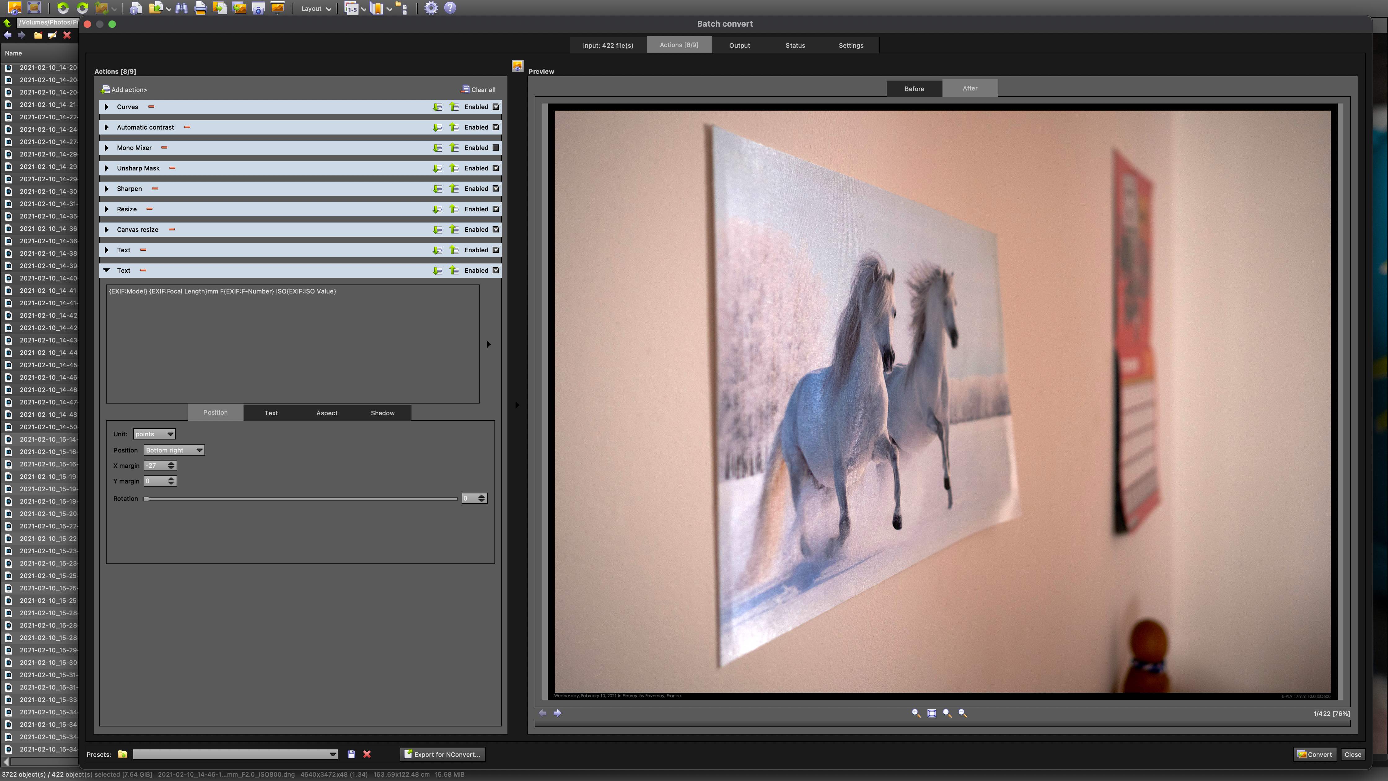

Another behavior questionable behavior is that when you manipulated images in the "Actions" tab, there's also a memory creep problem, slowly taking up more and more memory after about 20 minutes of manipulating raw files. Perhaps, it's related?

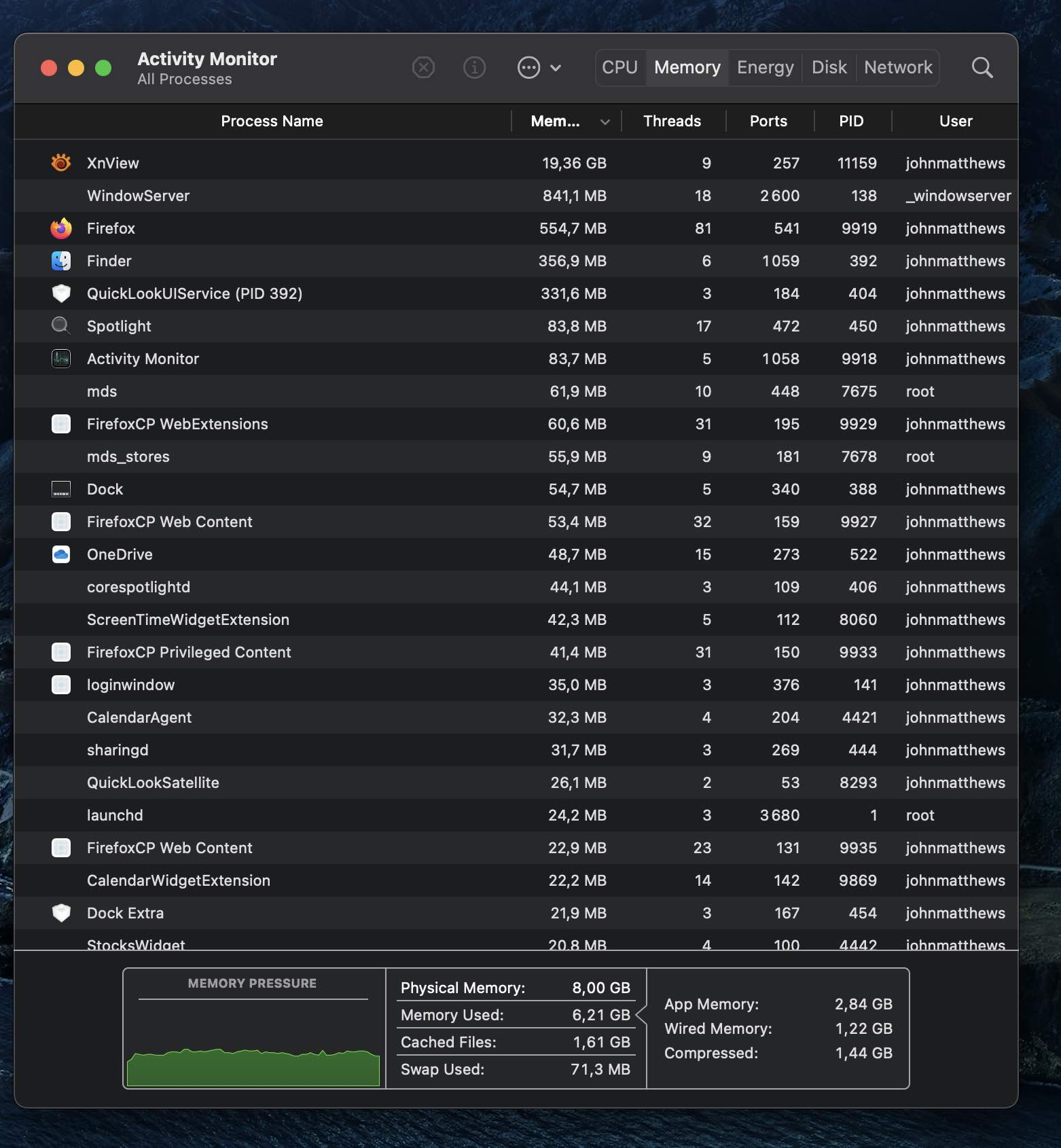

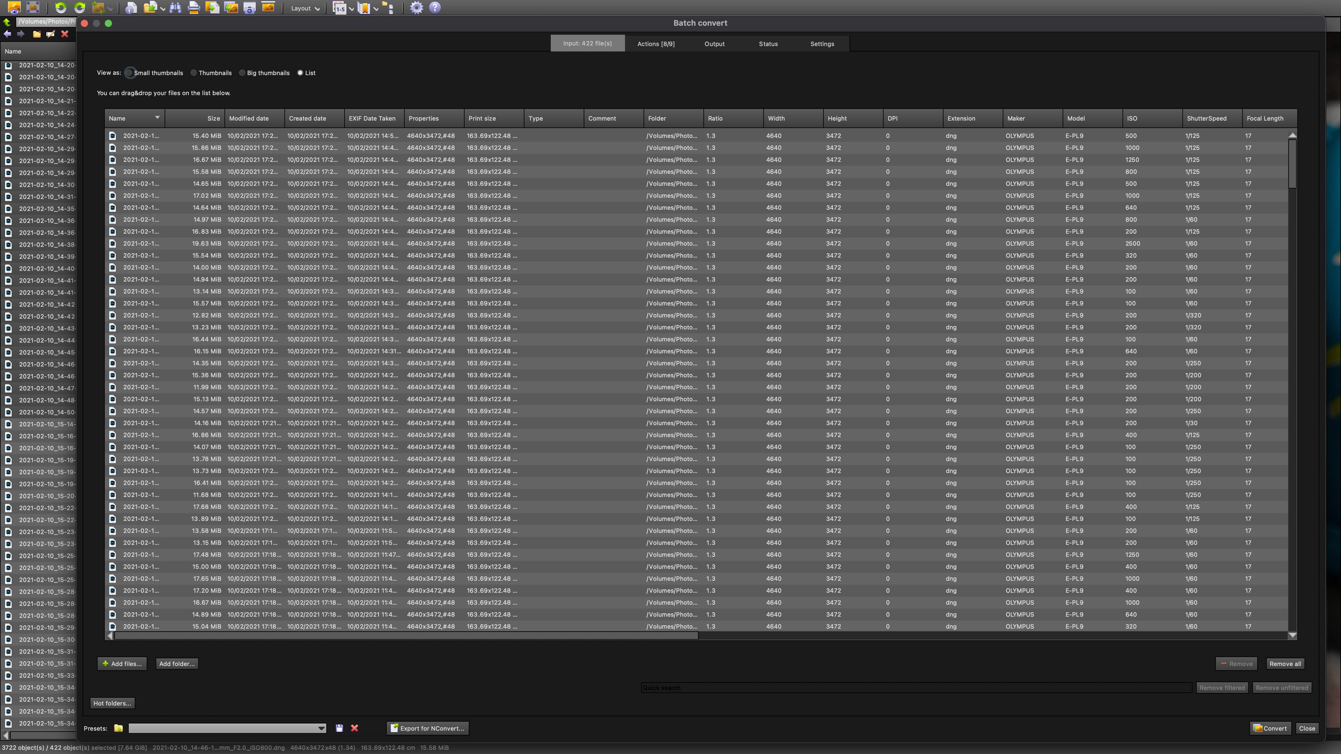

Attached is a screen shot result of having only 1 core doing the work. I stopped the processing after about 20 minutes. Even after stopping it, Activity Monitor is show xnview taking considerable memory and never releasing it.

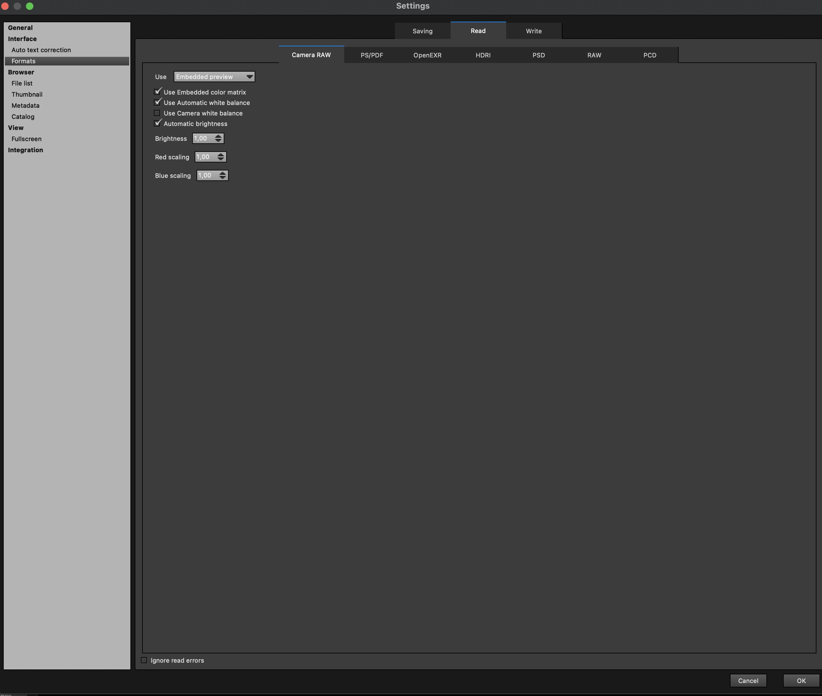

is it the 1.94 version?
and what do you have in 'load format settings' > RAW?

I have:
XnView MP MacOSX
Version 0.99.1 64bits (Sep 23 2021)
Libformat version 7.95
I could not find "Load format settings".
XnView MP MacOSX

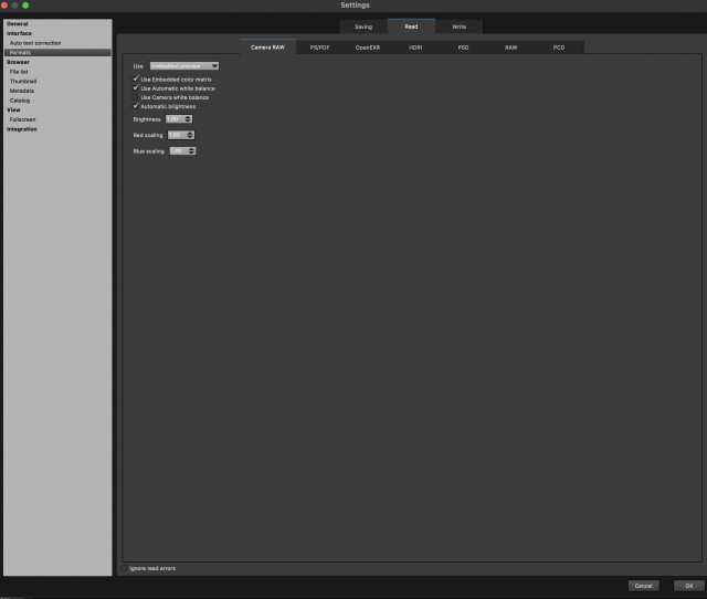

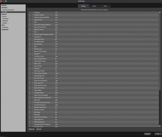

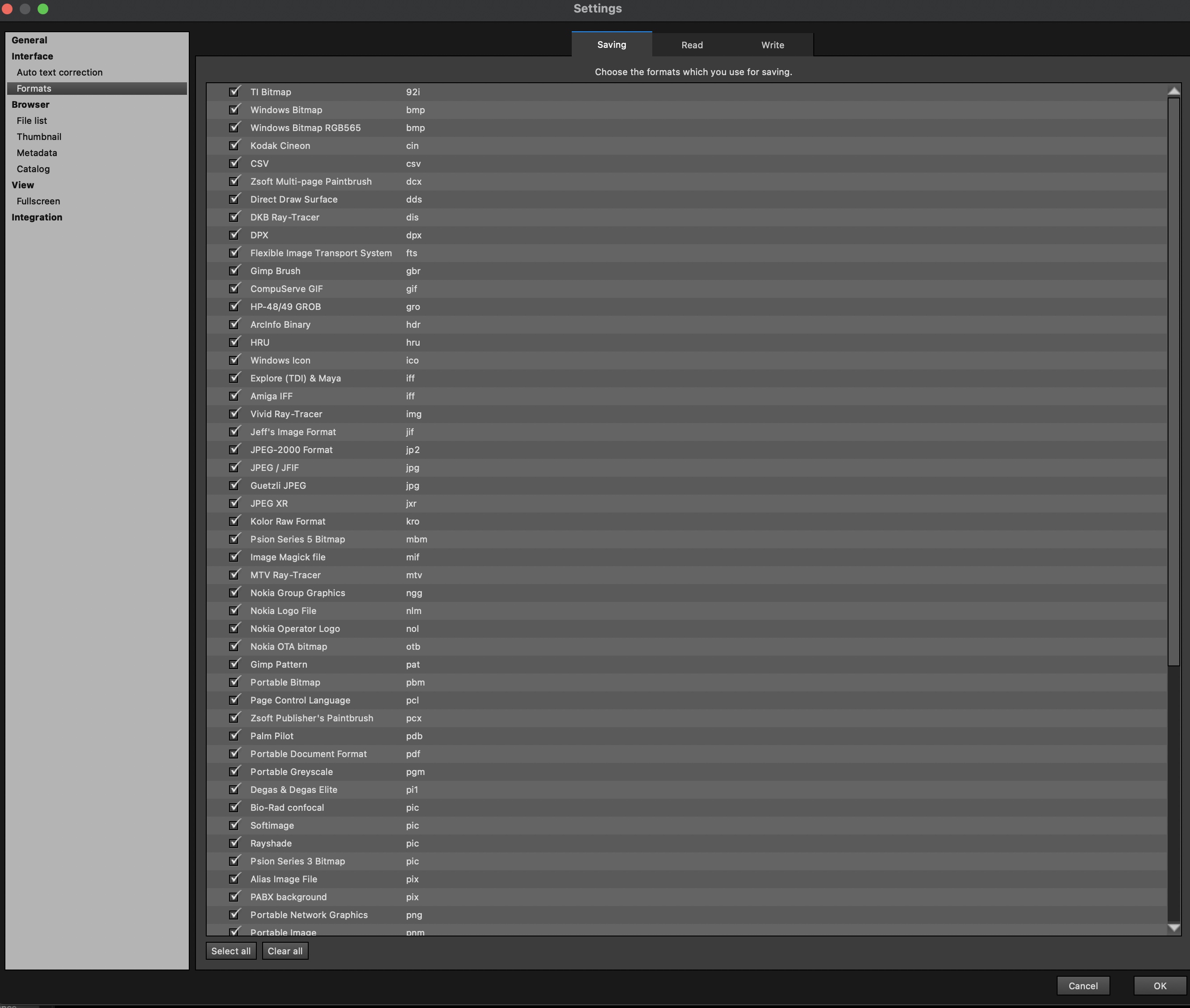

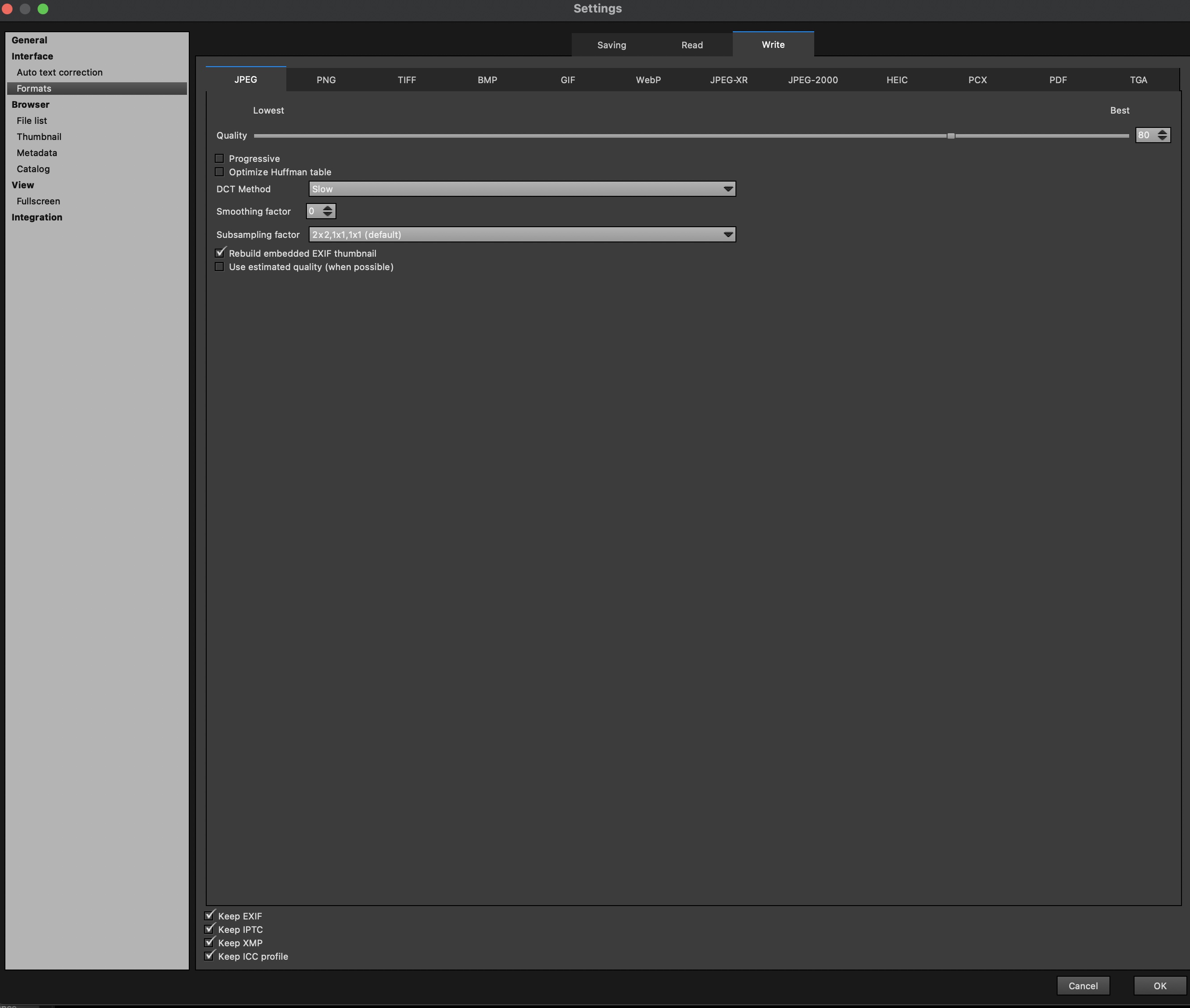

Here are my setting > Formats:
