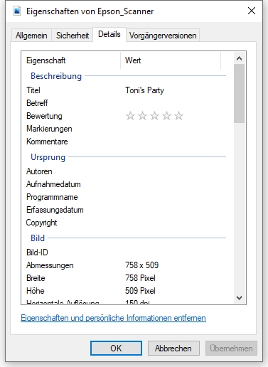

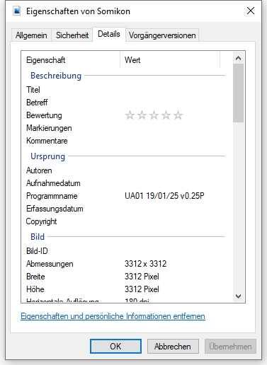

and could you post screenshot of properties for these 2 files?
JimP
- Posts: 6
- Joined: Thu Oct 28, 2021 9:15 am
Re: IPTC information not always viewable in Windows/properties
I hope these are the properties you are talking about. I have also uploaded the Epson_Scanner file to Google Drive in the hopes that the properties stay intact and you can download both example files and check out the details directly.
- Posts: 48627
Windows doesn't use IPTC metadata but XMP metadata. But it's strange because XMP metadata are correct for the 2 files, don't know why Windows can't....
