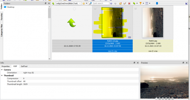

I have old files that have no EXIF-Information and are displayed in the wrong orientation. Therefor I added EXIF-Orientation with Exif Pilot.
Windows Explorer dsiplays the Images correct according the new EXIF-Information.

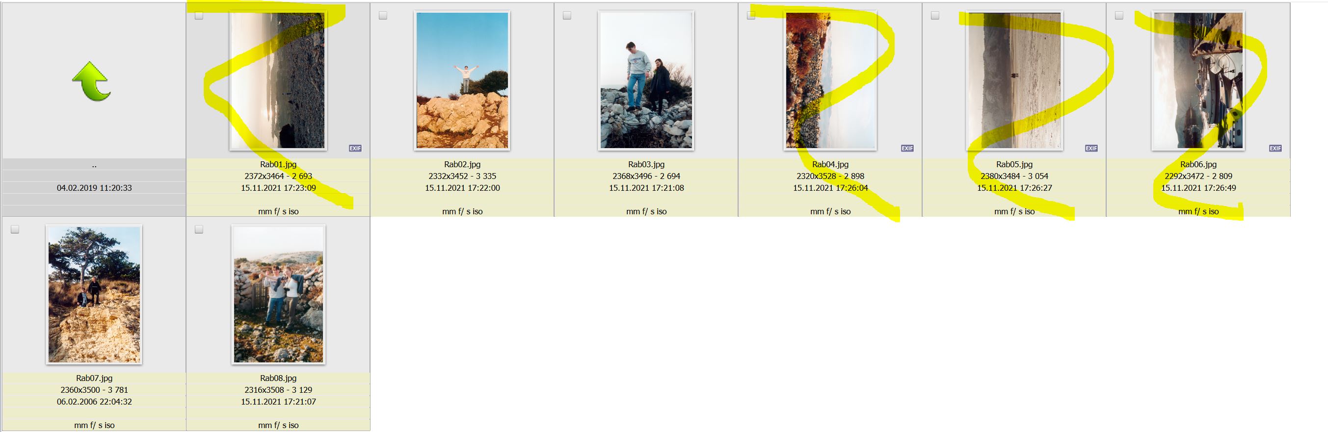

In XnViewMP the Images aren't displayed correctly! See Original.JPG.

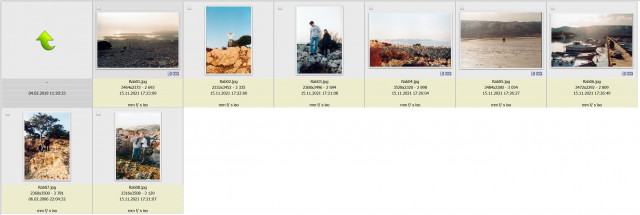

After "Rebuild thumbnails" the Images with the new EXIF-Information are display in the right orientation. They also have the orientation symbol.
BUT:
When I browse to another folder and back to this one, the images are displayed wrong again! I don't know why XnView dowsn't remember the correct thumbnails!
When I browse to a folder with newer files that have EXIF-Orientation Information too, there the images are displayed correct.
I tried restart the program and even rebuild thumbnails in catalog settings. No success.

Re: Thumbnails in wrong Orientation
You are right for this picture.xnview wrote: Fri Nov 19, 2021 9:18 am It's normal, this file is portrait not landscape, there is no way to know the orientation
However, I added the orientation Info in the other one and it is still shown in portrait until I rebuild thumbnails. When I change to a different folder and back to this folder, the second picture with Orientation Info is shown as portrait again until I rebuild thumbnails again.
Windows explorer shows the picture with orientation Info always correctly as landscape.
Gimp detects the orientation info too and displays the picture in landscape.
In XnViewMP I have to rebuild thumbnail each time I navigate to this folder to display this picture and others correctly.

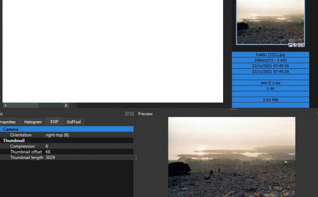

infosauger
- Posts: 15
- Joined: Sun Nov 07, 2021 11:51 am
Interesting,
I don't see it in landscape in the thumbnails. I have to rebuild thumbnails to see it correctly.
In the preview window it's always shown in landscape.
So there is something wrong with settings. But witch one. Newer pictures with orientation info are shown correctly.
