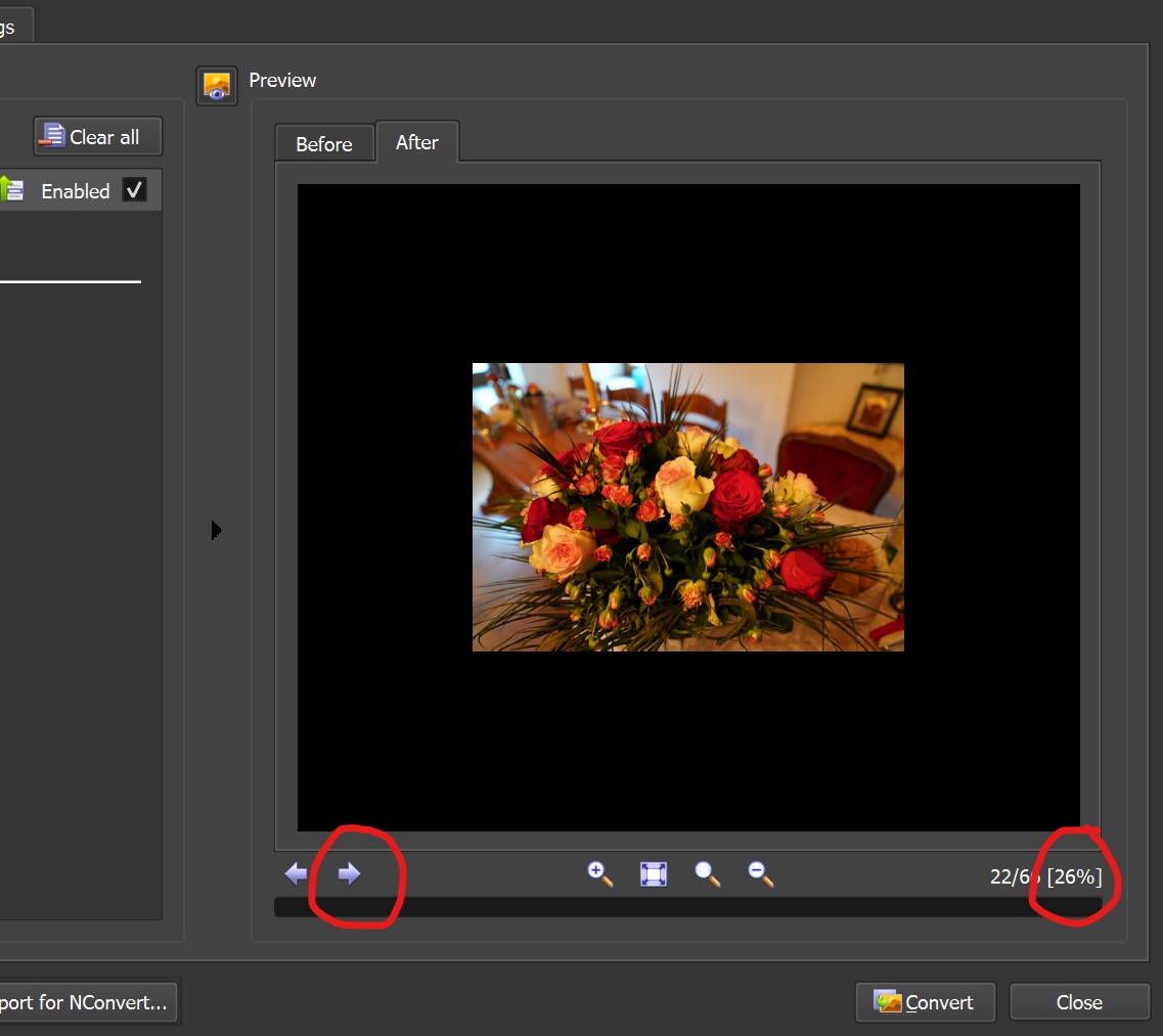

We have the Preview pane in Batch Convert dialog which has two tabs: Before and after:
No matter what Zoom we choose there, if we press the buttons Next or Previous, the zoom percentage resets at 26%.
It would be the best to keep the zoom percentage from the previous image.

Re: Preview in Batch Convert: Zoom is wrong at Prev/Next
It seems that by default it works.
The zoom percentage goes astray if we look at several images, and then click on the „Before” tab and after that click back on the „After” tab. Then the percentage is wrong and it stays like this.
The zoom is kept between files
Not if someone makes the mistake to go on the tab „Before” and comes back.
Then the zoom is fixed at „nn%”. No matter what zoom had te previous file in the „After” tab, it will be the „nn%” value for the next file.
