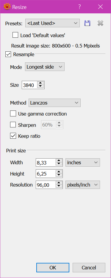

I dont know if this is a bug or not, but if i resize image by longest or shortest side and then will try to resize again, then the Resize dialog will use Last Used Preset but not the last typed value that is showed in the UI.
1) Here i used Resize dialog for the first time per session and typed 3840 + longest size. Result - the image is resized according to the typed value.
resize #1 (value is typed manually)
2) Here i used Resize dialog for the second time per session and and just clicked on OK. Result - the image is resized according to the Last Used preset but not the last typed value. You can even see that message in the UI "Result image size 800x600 0.5 megapixels"
resize #2 (with re-used "Last Used" values)

Same problem here. Looks like a bug to me. Very annoying, have to click Resample every time.

Only for 'Longest' & 'Shortest' mode, right?

xnview wrote: Fri Dec 17, 2021 3:56 pm :bugconfirmed: Thanks to your detailed description I can reproduce the problem.
I don't use them but i just tried and "Mpixels" and "Shortest side" were bugged too!
"Size(%)" and "Size(Pixels)" is unaffected on my PC.

This problem is supposed to be fixed in XnView MP 0.99.7. Please check and confirm the bug fix here.

xnview wrote: Thu Jan 13, 2022 12:36 pm This problem is supposed to be fixed in XnView MP 0.99.7. Please check and confirm the bug fix here.
Thank you, now it's fixed! :D
