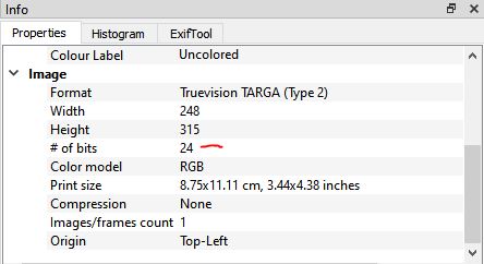

When you look at the file properties in the XNView browser, it is 8 bits:

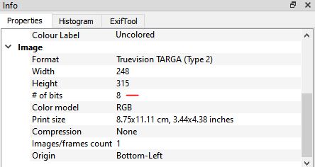

If you simply open that file in XNView and save it (doing nothing else to it), the number of bits changes:
I was hoping to use XNView to edit files and save them in the 8-bit format, but when saving TGA files, the only selections available under "options" are check boxes for "RLE Compression" and "Bottom-up Orientation". Can "bit size" be added as a selectable option? Or is there some other way to do that?

Kull wrote: Mon Feb 14, 2022 3:12 pm When you look at the file properties in the XNView browser, it is 8 bits: Before saving in XNView.JPG
It's a flase information, it's 24

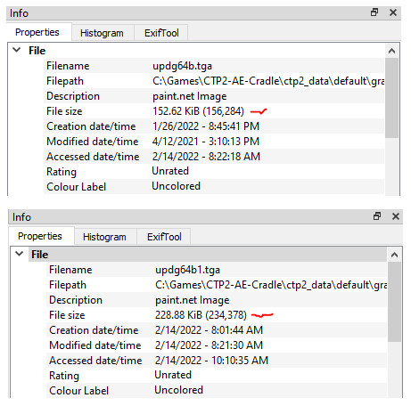

Well, something has certainly changed. Look at the image below and you can see the file size of the original (152K) has increased in the "saved as" version (234K). And the game will not display the altered file, but the original works fine. If the displayed bit size is "false information", than what is actually changing? And more to the point, can that be prevented?

Posts: 48172
Re: 8-bit TGA "Targa Type 2"
The original file use 16bits to store pixel, XnView expand it to 8bits per component. RGB 16bits is not supported in writing.
