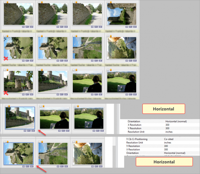

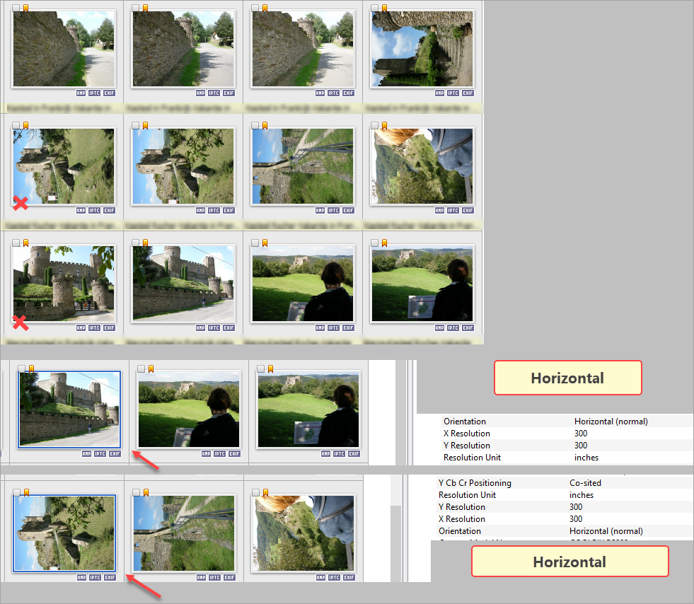

It strikes me that often portrait images are displayed landscape. I need to selectively change the rotation.
I have no idea whether there are settings to change the rotation, so photos show up the correct way by default, instead of me changing a lot.
Also, if I change the rotation - will it then 'stick' or will it change back again.
see below.
Thanks.

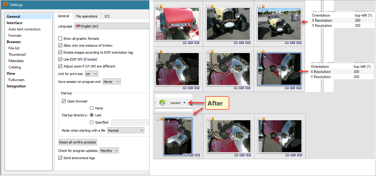

do you use setting to check EXIF orientation?
mrwul
Posts: 347
Joined: Tue May 25, 2010 7:01 pm
Re: Orientation
Post by mrwul »
xnview wrote: Wed Feb 09, 2022 1:30 pm do you use setting to check EXIF orientation?
Ehm...??
Where can I find that?
Posts: 48913
Re: Orientation
in Settings>General

Re: Orientation
Post by mrwul »
Ah! Overlooked.. sorry. Ahum.
It is tagged.
I can select the images and then use rotate in toolbar, but I wonder why it is not rotated automatically.

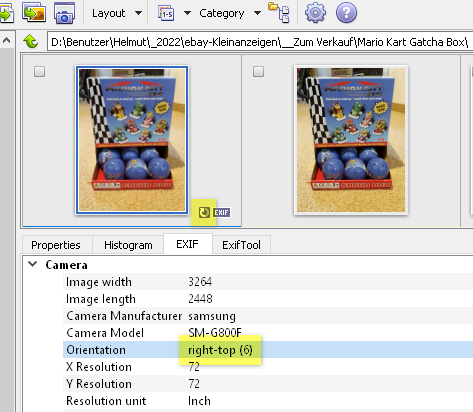

- XnView uses the EXIF information of images to get the orientation of images right.
- XnView displays a small info icon when automatic rotation is applied
This is what it looks like if XnView applies automatic orientation:
When taking a photo your camera or smart phone writes image data plus EXIF data including the EXIF orientation. If the EXIF orientation is wrong or is missing, then XnView cannot automatically adjust orientation. In your above example I see "Orientation: top-left (1)" in both images even though the bottom image (wine-red oldtimer) is in portrait format. To me it looks as if the EXIF orientation in your images is wrong.
To get the rotation of photos in JPG format right while avoiding lossy recompression I recommend to use "Browser > Tools > JPG lossless transformation > ...". The "Rotate left" / "Rotate right" symbols in the toolbar will also use JPG lossless transformation (given that setting "Use lossless rotation (if possible) in Menu "Tools >> Settings | Category "Browser | Tab "Misc" is activated. This setting is activated by default.)

Yesterday only, I found out it involves old photos taken with my (also very) old Nikon. All later photos, Canon, Sony and even my Samsung smartphone, the orientation is okay. It seems to have something to do with the internal software of the old Nikon.
Regretfully, the orientation within all the Nikon photos -all- read the same, top left, no matter whether it should have been portrait or not, so it is difficult to filter out the 'wrong' orientation as there is nothing to filter on.
I guess I make up my mind: leave things the way they are, or browse thru roughly 6000 photos, select all that are wrong and adjust them.
