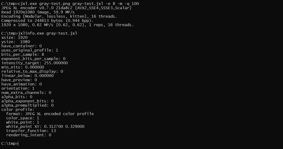

Wwctl
- Posts: 4
- Joined: Sat Feb 05, 2022 8:08 am
Re: 0.99.7: no JPEG XL output during batch conversion with greyscale filter
I don't think so, because the reference JXL encoder is able to deal with this image:masterjp wrote: Tue Feb 08, 2022 6:00 pm The problem is the JPEG XL encoder itselfs, which is used by XnViewMP!

It seems that image is saved in 8-bit sRGB instead of grayscale. That's what IM identify command says.
AKmatiAK
- Posts: 4
- Joined: Tue Apr 12, 2022 10:48 pm
https://github.com/libjxl/libjxl/issues/1342 - It's 8-bit grayscale but incorrectly reported bit depth
