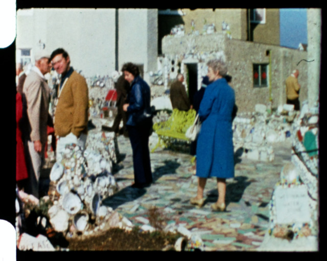

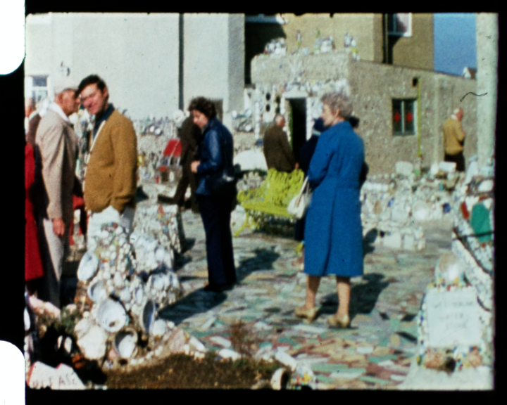

I have made a machine to scan 8mm cine films that my dad took in the 70s.
I was wondering if XnConvert can remove the black border from each photo. The only problem with using the 'crop' option is that it removes a fixed amount, which is no good as the size of the border changes slightly on some photos.
I have tried all other options but no joy. I thought Automatic crop with colour selection would sort the borders, but I must be doing something wrong.
I could do it manually with XnView - 'Crop/Save/Next' option which is great but it would take me many years!
I attach two pictures, (they are out of focus, but ignore that as it was only a test).
I have reduced them in size by a huge amount for upload here.
