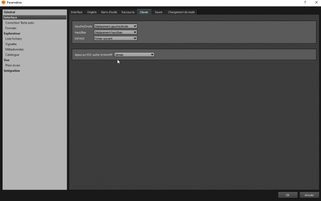

I have Startup set to Normal & Interface>Keyboard>'Pressing Esc once quits XnViewMp' to Never. Yet when I open an image and hit esc XnView closes. My desired behavior is that esc should do nothing if not in fullscreen mode (the standard behavior of 99% of other programs (chrome, vlc, firefox, notepad, photoshop, word, etc.)), or alternatively open the current tab/image in the Browser. It is very unnatural for esc to close an application without warning. It the very least there should be a one-time 'Do you want to quit?/Remember my answer?' dialog if people want to keep this behavior. I understand esc is acceptable to close windows that are fullscreen, but not to quit a windowed application.

Re: Disable Quit on Esc
It's in Settings/Interface/Keyboard

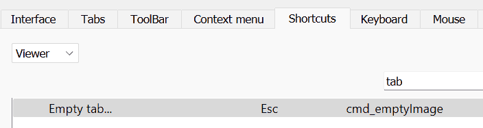

hm, it looks like you can achieve desired behaviour by messing with shortcuts:
- goto shortcuts
- assign ESC to any action, e.g. cmd_emptyImage
however, it will stop quitting fullscreen via ESC as well
