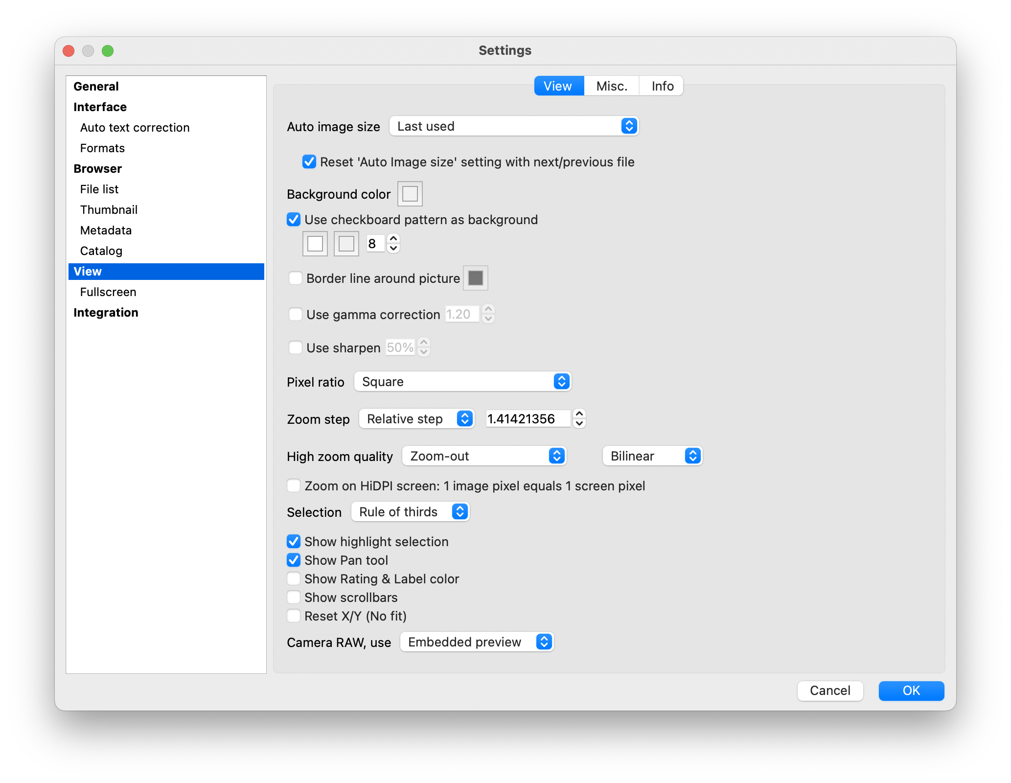

No. X/Y reset is not active. I attach a screenshot of that settings' section

Re: reset view to top
Please give the following configuration a try:
- Go to Tools → Settings… → View → View.
- Set Auto image size to Fit image to window width.
- Activate Show scrollbars.
- Activate Reset X/Y.
- Go to Tools → Settings… → Fullscreen.
prschwob
- Posts: 5
- Joined: Tue May 17, 2022 10:02 pm
That worked!! Thanks a million.
