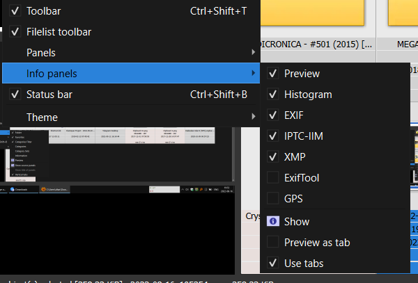

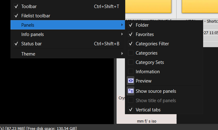

I've found the problem. Turns out I have to enable 2 options: Panels - Preview and Info panels - Preview.
I'm not sure what happened, I didn't change any settings before and after installation.
The bug is fixed in 1.01. Thank you.
Panels - Preview
