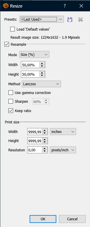

So, first I resized the image using these settings:

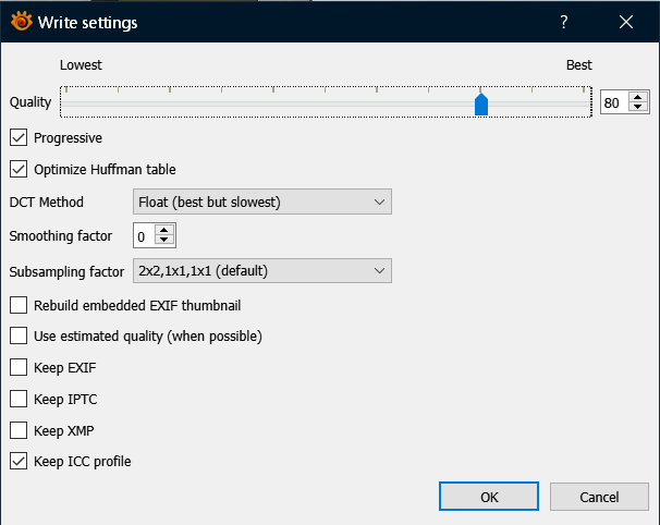

Then I used Save as... using the following settings for JPG:
The resulting file "Test-SaveAs.jpg" was 1,151,532 bytes large, so even larger than the original.

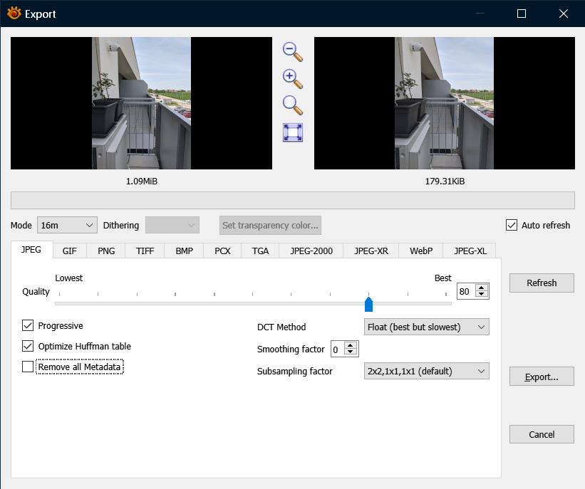

Then I tried again, resizing the original image and this time using Export... using the following settings:
The resulting file "Test-Export.jpg" is only 183,614 bytes large, so 6 times smaller than the "Test-SaveAs.jpg" which I expected to be about the same size.

I barely read the post.. but I did see Keep ICC Profile ticked... ICC profiles can be much larger than the image itself.. so untick that and see if that makes the difference then you'll know what was causing it.

Koogle,
Indeed, you were right, thank you!
