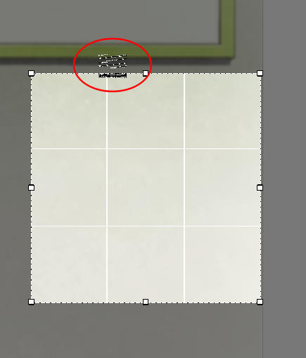

Mouse cursor "rotation" is broken when using "Crop" when display scaling is set to 125%.
Effect: The "rotated" mouse cursor is not displayed correctly, please see the attached image
0. Set display scaling to 125%
1. Open an image
2. Click the "Crop" icon on the toolbar
3. Frame the image with the mouse
4. Move the mouse to the outside of the selected frame
5. The problem occurs: The mouse cursor is displayed abnormally.
Actual behaviour (bug): Mouse cursor "rotation" is displayed abnormally
Expected behaviour: Mouse cursor "rotation" is displayed normally
Thanks for the reply, here is the addition(has been added to the original text above): the problem occurs when the display scaling is set to 125%. (It may not be expressed accurately, I don't know what this setting is called in English, anyway it is the scaling used for high dpi displays)
The attached image has now been added.

Until now, I didn't know that in cropping mode selection can be rotated. When rotating, a mouse cursor is displayed when moving the mouse towards outside of one of the four corners of the image. This all looks good to me. Could you please post an image displaying the "broken" mouse cursor (In your previous post the attached image is missing)?

it's a QT bug, i contact the team

This problem is supposed to be fixed in XnView MP 1.01. Please check and confirm the bug fix here.

xnview wrote: Tue Aug 16, 2022 10:13 am This problem is supposed to be fixed in XnView MP 1.01. Please check and confirm the bug fix here.
Confirmed, the issue is fixed in Version 1.01. Thank you!
