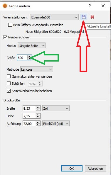

I attached a screenshot!
I change the field (green arrow) to "600" and save it at the dialog (red arrow) when i pressed the save icon the
the field content (green arrow) is reset to "0"!!
Wrong way ?

This problem is supposed to be fixed in XnView MP 1.3.0. Please check and confirm the bug fix here.

I was able to create a "Evernote600" preset with 600 holding as the size afterwards, Fix confirmed
However, after deleting "Evernote600" preset and choosing "Default" preset, size remained at 600! Now with "Load "Default" values checked, I click "cancel", close XnView MP, reopen and size is back to 729x1200 (the image I currently have open at the time)
