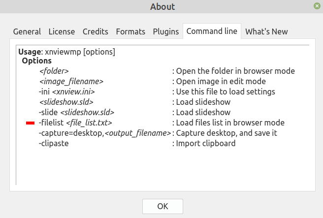

I believe that XnConvert supports the XnView MP filelist start option indicated below:panathos wrote: Thu Aug 25, 2022 3:59 pm There is a way to automatic XNconvert when used with "XNconvert @filelist" ?
So you would seem to need to insert the missing '-' sign shown.
I'm not sure how many of the XnView MP command line options shown above are supported in XnConvert, as far as I know it has never been documented, perhaps those supported should be shown in the About tab.

The following fairly recent post does indicate that the XnConvert @filelist form you are using is supported, whereas the XnView MP format I posted above does refer to loading a filelist in XnView MP browser mode, so not equivalent.
It doesn't seem clear whether conversion should be initiated immediately, or whether only the files in the filelist are loaded to the Input tab, and again perhaps the option should be documented somewhere in addition to the XnConvert 1.95 change list.
