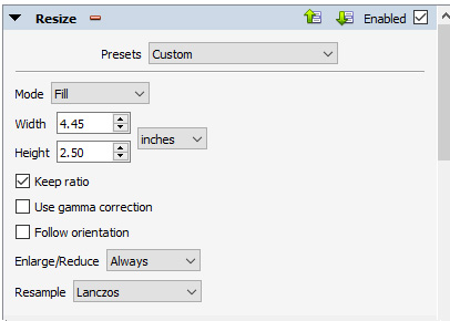

I want to resize a batch of images and I can't figure out how to get the results I need.
All the images need to be 4.45" wide by 2.5" high. I understand that some of the image has to be cropped off and that is OK. Resolution is not important.
My test input image is 6000x4000 pixels.
From what I understand, Fill should give me what I expect, but it doesn't.
Here are my settings.
Here are the results using various settings.
Fill mode: 4.451" x 2.959" @ 350 ppi
Fit mode: 3.751" x 2.5" @ 350 ppi
I get the correct size if I uncheck Keep Ratio but then the image is distorted.
I've tried combining resize with a few other actions but can't come up with a combination that works.
XnView constantly surprises me with what it can do. Is there a way to do what I need it to do this time?
Thanks!

chuck902 wrote: Wed Sep 14, 2022 10:24 pm I want to resize a batch of images and I can't figure out how to get the results I need.
I think you probably need Canvas resize rather than the Resize action.
Disclosure: I'm not familiar with the Resize action the way you are using it, so possibly that can be used.
