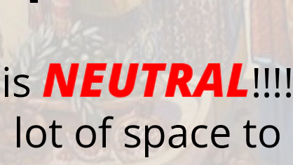

As shown, enabling Sharp YUV improves the areas around the color boundaries by quite a decent amount, putting it nearly at parity with the original PNG. This would improve WebP performance when encoding digital artwork, where sharp color boundaries can be quite prevalent. As another example, here's a section from a digital "poster" I made with red text over a background. Here's a CWEBP encode done with (and converted back to PNG for consistency):
And this is what it looks like with :
With Sharp YUV enabled, the color of the red text appears nearly as sharp as the original, whereas without it there seems to be a sort of dark inline despite being encoded at quality 100.
None of the various save presets (Default, Photo, Picture, Drawing, Icon, Text) seem to enable this feature, so it would be nice if it could be added as a separate encoding option, maybe in an upcoming release.

I created an account so I could also ask for this feature. WebP's default subsampling behavior just does not look as good as it could without Sharp YUV enabled. There's quite a handy example displayed on another forum here: https://irfanview-forum.de/forum/progra ... ests/12925
-q 100 -m 6Code: Select all
-q 100 -m 6 -sharp_yuvNone of the various save presets (Default, Photo, Picture, Drawing, Icon, Text) seem to enable this feature, so it would be nice if it could be added as a separate encoding option, maybe in an upcoming release.
Thank you!
